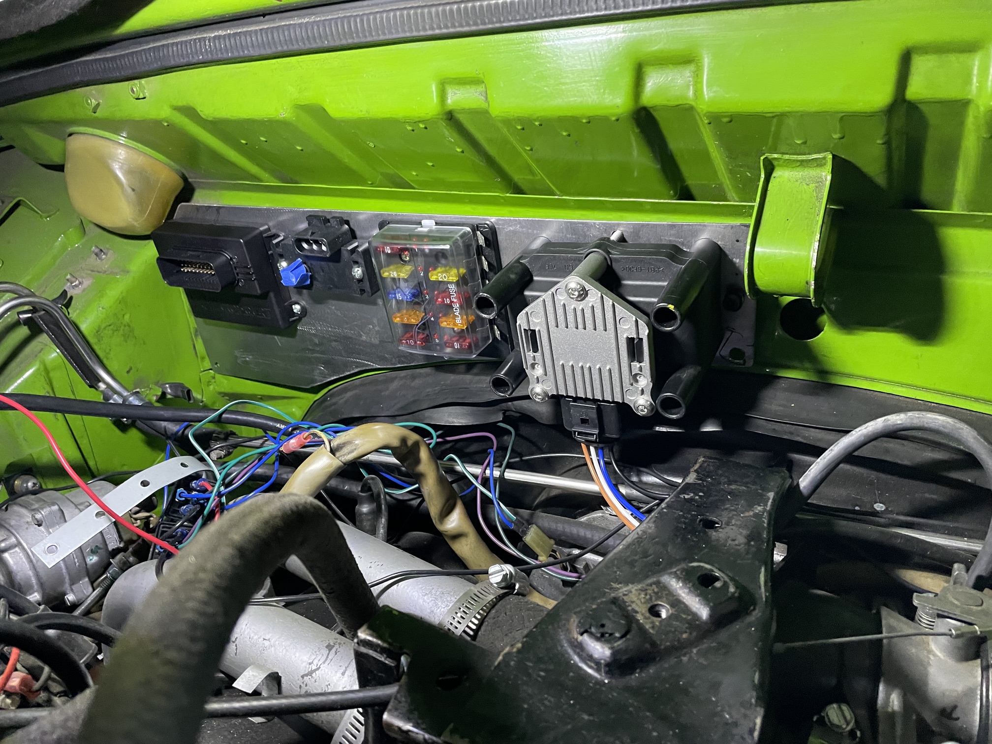

IGN Coil - wasted spark VW 4 tower

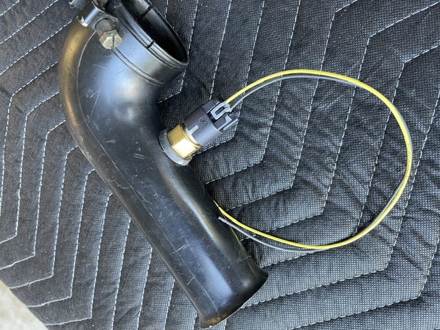

CLT and IAT by GM – Dubshop, CLT mounted on ring terminal at #3 cyl, IAT mounted on intake tube of the air cleaner.

Clean setup! (IMG:style_emoticons/default/smile.gif)
