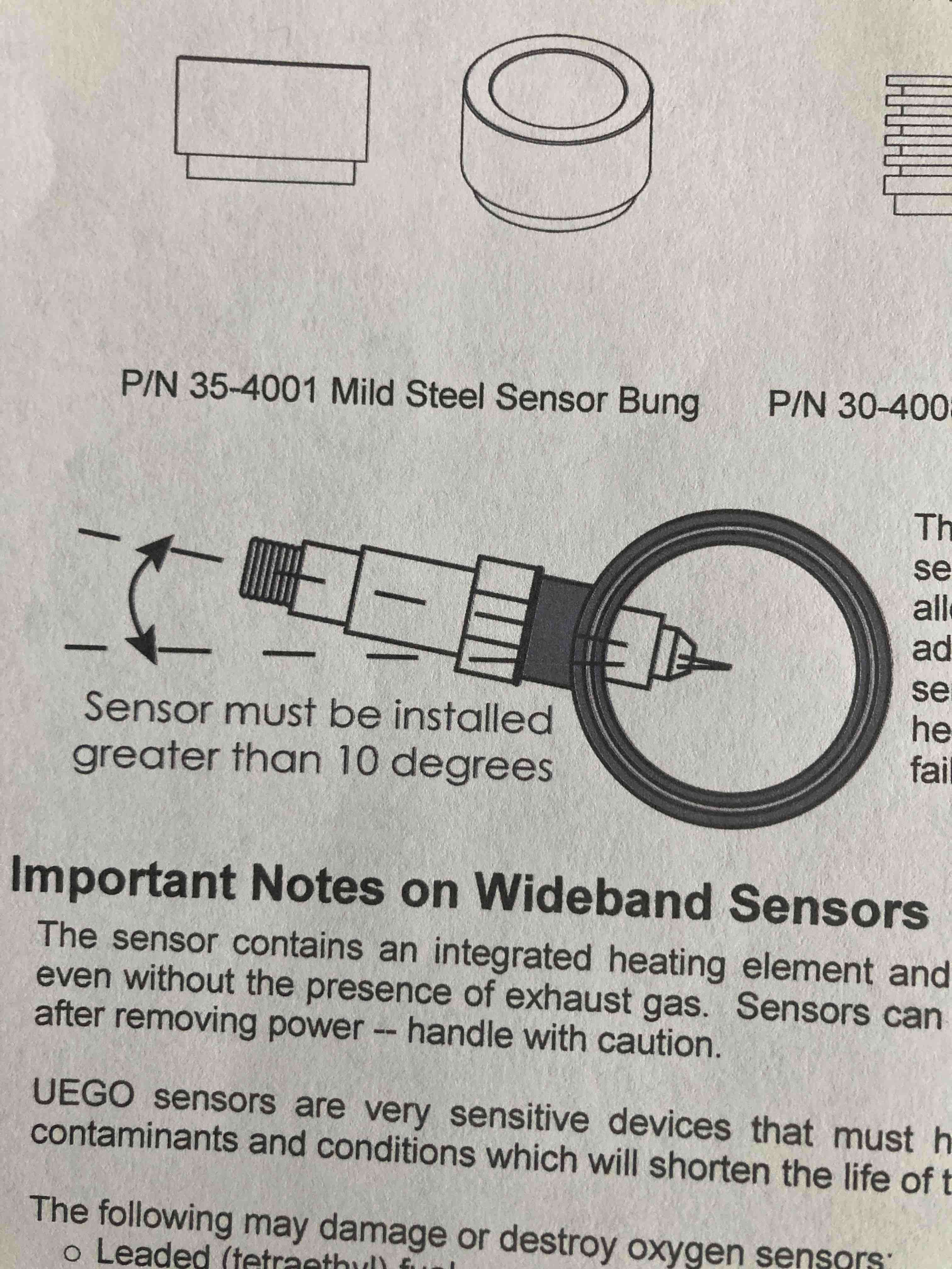

Hello ,
I just installed this exact model but I do not have the muffler you have but wherever you install it make sure it is greater than 10 degrees.
