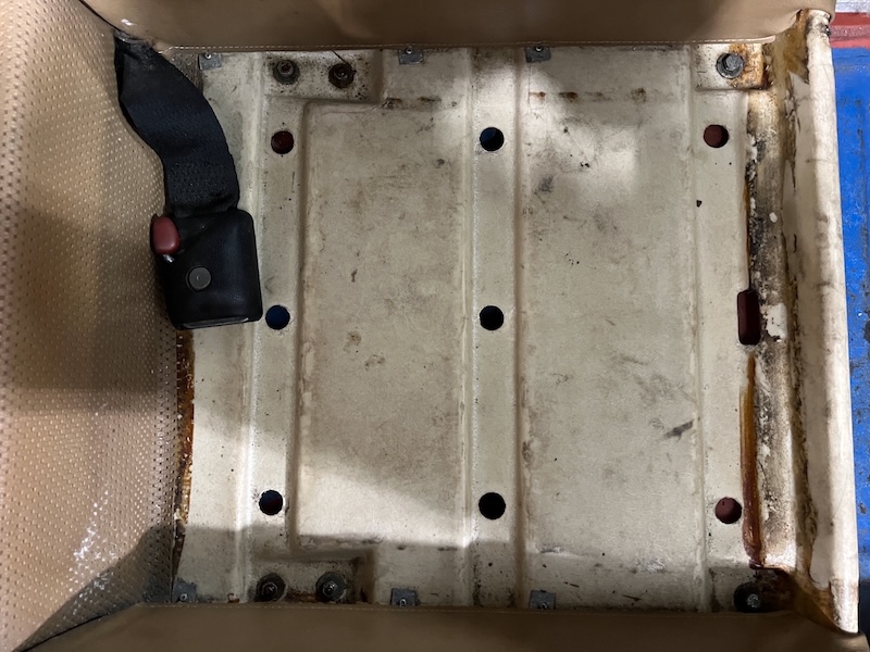

I'm in the process of recovering my seats. The fiberglass passenger bucket has three holes on both sides of the base. Does it bolt directly to the floor? No brackets? I can't remember how it came out of the car. Seems weird to bolt it directly to the floor?
Speedo 1970 non adjustable passenger seat mount Jun 8 2026, 03:23 PM
gereed75 dont have mine out in front of me but I seem to re... Jun 8 2026, 04:12 PM
aturboman The fiberglass base is held to the floor by (4) sm... Jun 8 2026, 04:23 PM
DennisV
Does it bolt directly to the floor? No brackets? ... Jun 8 2026, 04:31 PM
Speedo Thanks everybody! Jun 8 2026, 05:38 PM
rudedude I believe there is also a small 2 hole plate that ... Jun 9 2026, 07:30 AM
DennisV
I believe there is also a small 2 hole plate that... Jun 9 2026, 01:32 PM
mepstein No hold down plates on the early seat base. Even t... Jun 9 2026, 01:45 PM![]() ![]() |
