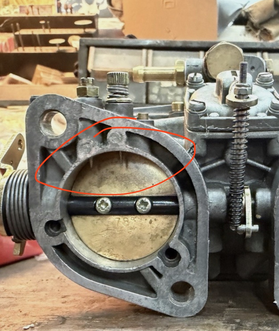

This isn’t right at all minimum. Needles shouldn’t be hanging this deep into the throttle bore like this.
There are a couple possibilities
Wrong needles
Someone has reamed the needle seats way too deep or completely gone.
Doesn’t explain why they would be leaking without engine running but if someone has done something stupid with the needle seats there are probably other issues (IMG:style_emoticons/default/confused24.gif)

QUOTE(Superhawk996 @ Jun 25 2026, 01:08 PM) *
Wrong needles
I purchased the needles from Pierce Manifolds, so I would assume they are legitimate.
This is exactly the kind of thing I mean when I say that all of my carburetor knowledge has been built on inexperience and trial and error. I’ve never actually seen what a properly sorted set of carbs is supposed to look like or how they’re supposed to behave, so sometimes I honestly don’t know what is normal and what isn’t.
I’ll try to take some more pictures when I’m back in my workshop, but that won’t be until Monday.
At this point, I’m honestly not even sure if I should sell these carbs. I don’t want anyone else to end up getting a raw deal like I did when I bought them. At the same time, I’ve invested a significant amount of money replacing virtually everything except the carb bodies themselves, so naturally I’d like to recover at least some of that cost.

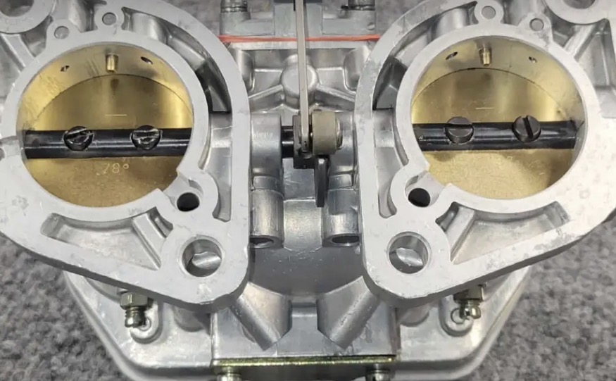

If I were betting someone has messed with the idle needle seat(s)
Not all Webers have the brass seat, insert but even so I’ve never seen an idle needle sticking that far into a throttle bore.
Do the paper towel test while you have them on the bench
