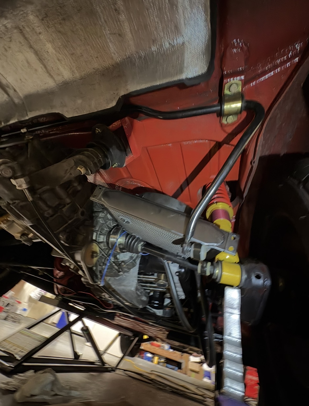

Engine Update (10/18/2026)
Pic of the “to be” installed oil cooler. Will begin the install to the bottom of the trunk on Wednesday.
Reassembly Tasks
  • Finish A/C compressor install
  • Finish intake install
  • Hook-up engine harness (oil press warn light, coil, etc)
  • Hook-up alternator (relay board + starter)
  • Run fuel hose from regulator to carbs
  • Install new remote oil cooler with brackets
  • Install battery
  • Install exhaust
  • Install charcoal canister and hoses
  • Hook-up catch can and return line
  • Install/adjust clutch linkage
  • Install speedo
  • Install new TR shift rod on previously modified TR shift console
  • Verify/Adjust Shifter Pattern
  • Hook-up AFR sensor
  • Hook-up #1 & #3 CHT sensors
  • Mount AFR Gauge in Interior
  • Mount CHT Gauges in Interior
  • Reconnect Inner Heim-rod bracing
  • Reconnect Aux Air motor and Tubing to Heat Box Intake
  • Reconnect Oil Temp sensor
  • Reconnect Oil Pressure Gauge Wire
  • Clean-up, Tie-back all wiring
  • Reinstall TR Heater Box (optional)
  • Install Engine Hood
Pre-Start Checks
  • Check Valve Lash
  • Add Fuel to tank/ Prime Fuel lines / Check for leaks
  • Verify Starter Operation
  • Check Oil Level
