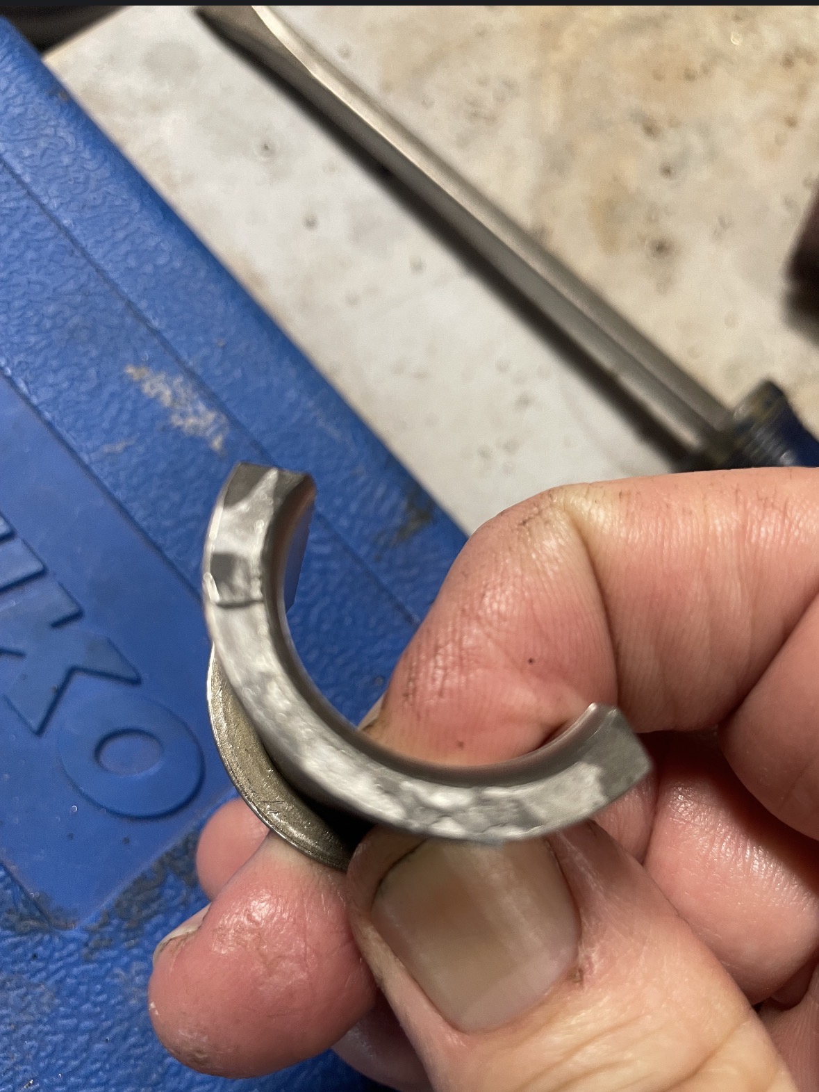

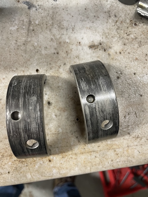

I would... but I saw the condition of the bearings coming out of this case 18 months ago (below) (IMG:style_emoticons/default/blink.gif) The engine had less than 5,000 miles on it. I'm erroring on the side of caution here.
UPDATE: Today the W case shipped back to EMW and the EC case went to Brother's VW Machine. Both cases will arrive in CA on Monday. Here's to getting something back that is in spec. (IMG:style_emoticons/default/beer.gif)

Question for the brain trust:
Would you say these bearings suffered from ill fitting or contamination?
and how much did they suffer? was the oil pressure acceptable? engine runing ok?
Ninja
post Jul 15 2026, 01:26 PM
Post #89
Posts: 323
Joined: 25-September 25
From: Granbury Texas
Member No.: 29,004

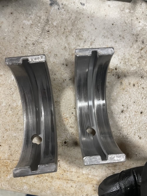

Ill fitting!
But I'd want to see all of the bearings in order with correct clocking to look across the entire set.
The picture at 5K looks like a "COME BACK" to me.

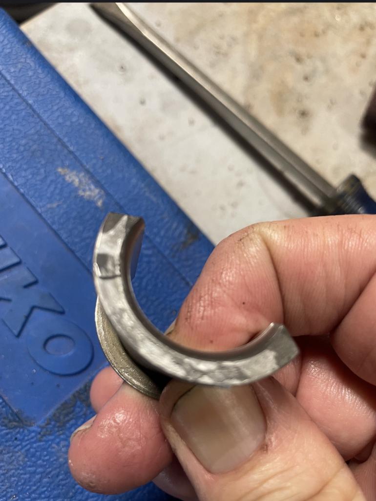

Note the backs of these same #2 bearings. Note: these are old pics that Rick has already seen.

Once again, I am not a "real" engine builder, but if I had to guess my bet would be contamination. Bearing surface does not appear wiped out. How was the engine running prior to removal?

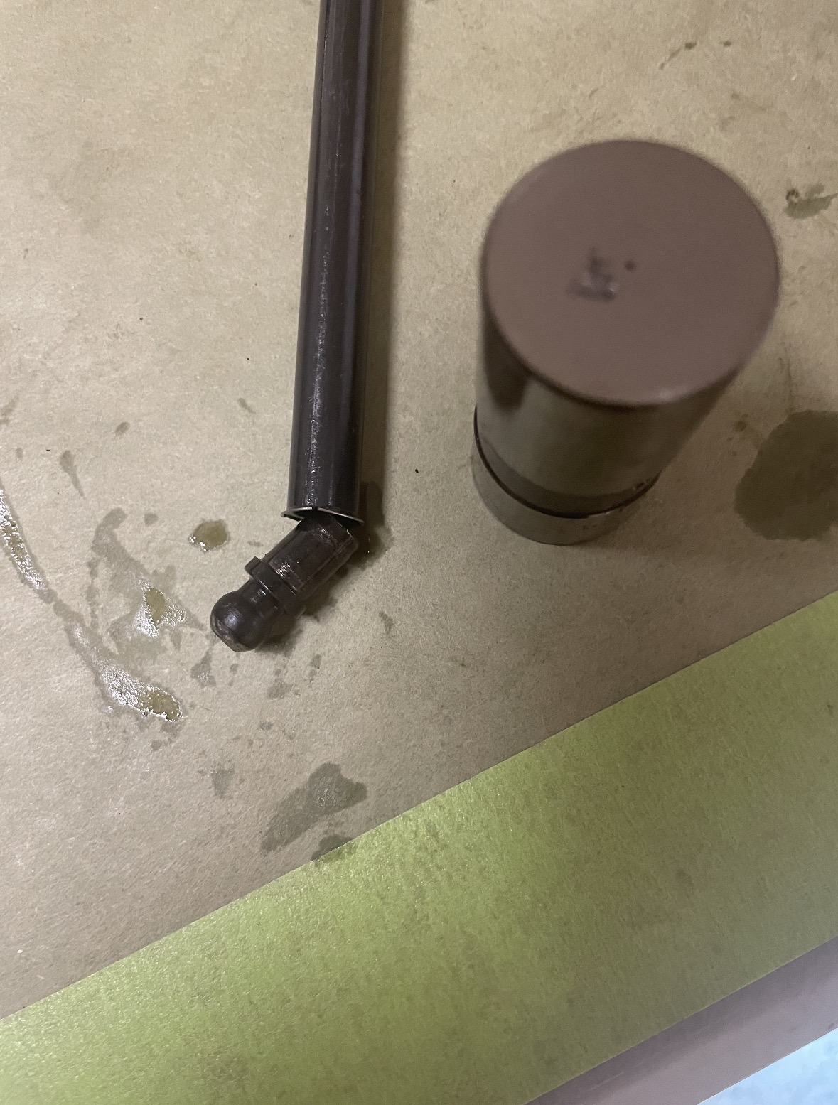

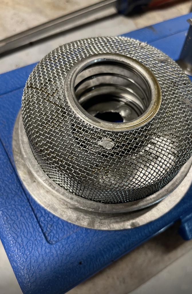

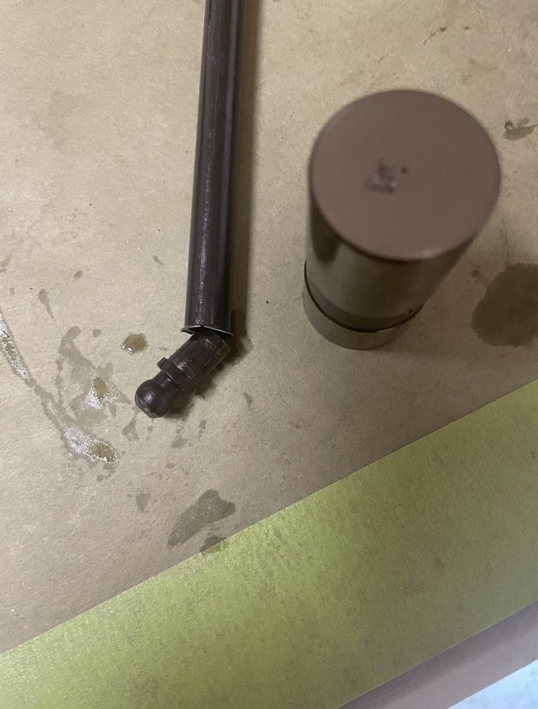

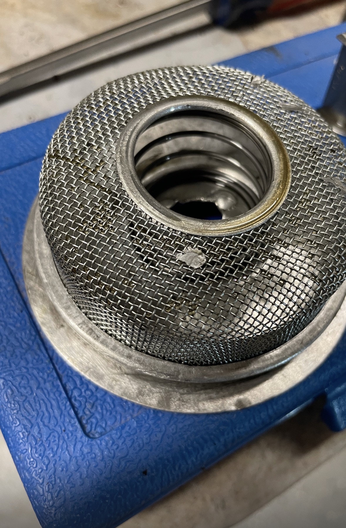

It ran but there were multiple issues at play here. The top end of the motor was built incorrectly. The cam’s thrust bearing surface was flaking off and one of the pushrods had mushroomed and was causing damage to the top of the lifter. The reason I pulled the engine was due to metal in the oil. So, while I think the bearing clearances weren’t good, the top end was beginning to come apart and contaminated the oil.
Attached Image. Attached Image

In the past yes, but what can we learn from this mess?
My $5.00 would go with contamination from pushrods, improper thrust, .... falling apart

Let me bring everyone up to speed on the history of this engine (it isn't pretty).
1) 2019: Engine goes to Fat/Rimco for machine work - decided to have them build the long block (during Covid).
2) 2021: Put my new engine on test stand. Break-in engine - no issues.
3) Run engine a 2nd time to verify timing adjustments. 5mins into test run, engine begins bellowing smoke bad.
4) Call Rimco. Pissed. I am told to install into car and drive it.
5) Drive car with new engine - continues to blow smoke, gets worse and then seizes.
6) Tow car back home, call Rimco. I am told that since they only built a long-block they aren't at fault here. I'm pissed, tell them what I think of them (and their mothers). (IMG:style_emoticons/default/headbang.gif)
7) Tear-down engine myself, find a metal ball of shavings in #2 main oiling hole in crank blocking oil passage. Really pissed off!
8) 2022: Decide to build it back myself... pay more money and get crank ground and purchase new 96mm cylinders, bearings, etc. Rebuild motor myself but don’t make any major changes – assume value-train is correct.
9) Install engine and it runs great for 2 years not a ton of power but it runs. All is good till metal shows up in oil.
10) 2023: Fat/Rimco goes out of business... because they absolutely sucked and possibly due, in part, to my "negative word of mouth" campaign (IMG:style_emoticons/default/stirthepot.gif)
11) 2024: Tear down engine again. Realize that Rimco’s deck height measures over .080. Also, determined that I used the wrong ring set for the low profile KB pistons (needed to be pinned (IMG:style_emoticons/default/headbang.gif) ). The loose oil rings trashed another set of 96mm cylinders. Find cam thrust bearing damage, and push-rod and lifter damage.
12) 2025: Send parts to Automotive Machine & Supply to get case looked at and parts modified and balanced.
13) Wait 18 months patiently - finally tell owner that I have a spare case (since that was the hold-up). (IMG:style_emoticons/default/yellowsleep[1].gif)
14) 2026: Pick-up parts and start taking measurements – realize cases are not within spec.
