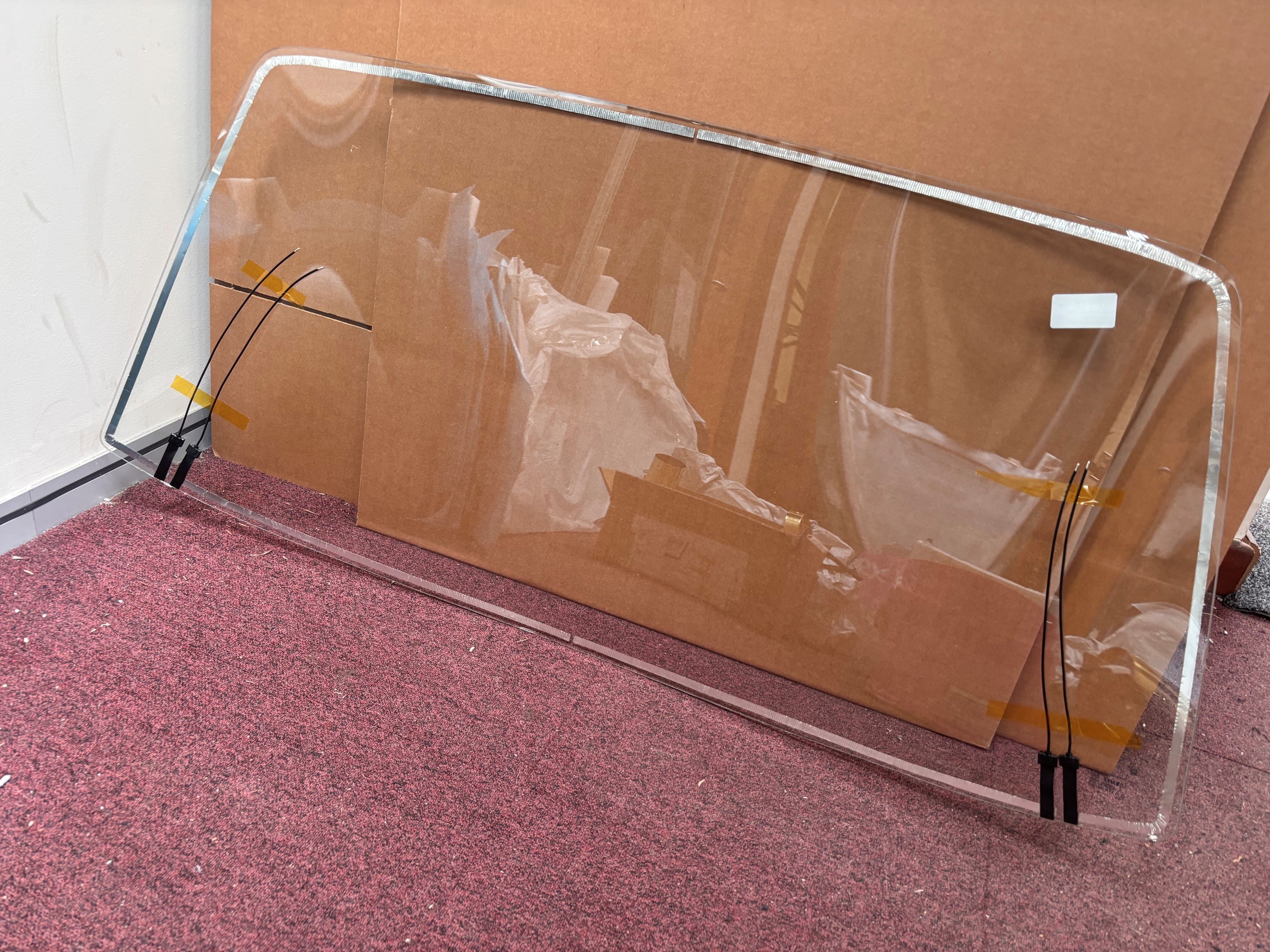

@GregAmy - Here's what they say on their site:
Our heated windscreens aim to eliminate condensation, de-mist and speed up de-icing of the glass, allowing for a clearer and safer view of the road ahead. This could be the difference between winning the World Rally Championship or simply giving yourself 10 minutes extra in bed on a cold winter's day.
The heated windscreens use almost invisible tungsten elements which work to increase the surface temperature of the glass, and in turn quickly clears the screen increasing visibility.
With the exception of a few, all of our screens use a dual heating system meaning that there is a live and an earth wire on each side of the heated windscreen, each one will power half of the screen. If you are unsure please contact us to confirm if you have a single or dual element screen.

I've been communicating with them asked to see any pics of the windscreen and installed pics. None available of one installed but here's the screen.
I'm clarifying that once installed:
- the black leads essentially fold down around the windshield frame lip and head off to be connected
ANSWER: Yes
- the silver elements are hidden under the windshield trim
Each screen varies slightly as the buzz bar is a done by hand so I wouldn’t guarantee it. I can try and speak to a fitted I know who has taken a few to be done to see if he recalls it. But we are a motorsport based company so not everyone is putting these in road / show cars.
Assuming so, I'm ordering one.
Heads up that it sounds like the "multiple screens" shipping requires a pallet and a business name / address.
I'll keep you posted...

I asked about how visible that silver element (the buzz bar) might be. His reply:
We have another batch coming through where we have suggested a thinner buzz bar to the factory on these (and a few others models) they are due in September if you wanted to wait and see?
I told them I'd wait. As always, you'll know more when I do.
