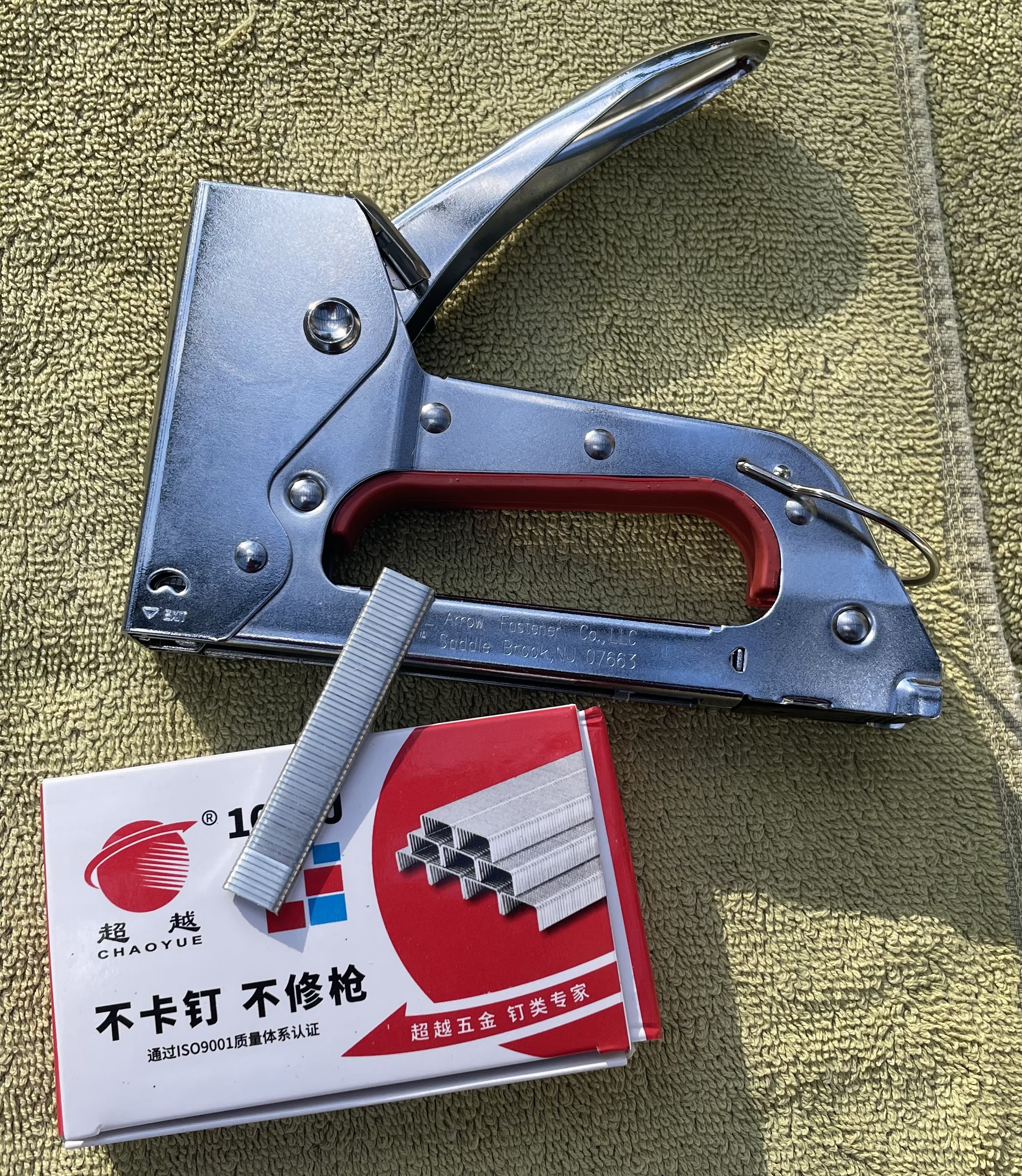

Sorry looks like I posted what I bought on the FB 914 Canada group. Here is what I used. Worked perfectly.
Meite 7104 Staples
Meite MT7105 Stapler
