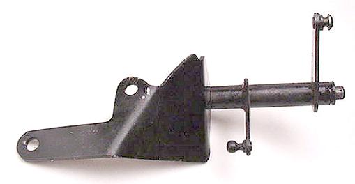

Not necessarily. This is a bracket that used to be available to use a side shift trans and mount the post.
I bolts to the two lower tail cone studs.
I think i can reproduce a bracket like that.
[/quote]
If Bruce can make these side shift brackets that would be great. I've made a few in the past. I made one for my brothers 6 conversion a while back too. It doesn't look as nice as what's posted but it works.
[/quote]
[/quote]
Well that will do the trick. I imagine it does need to be super stout as there's not a ton of force on it.
