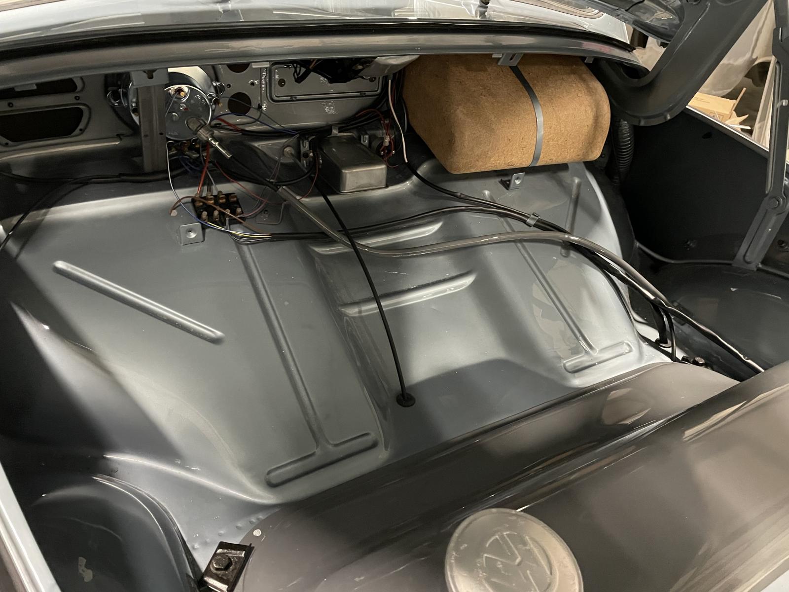

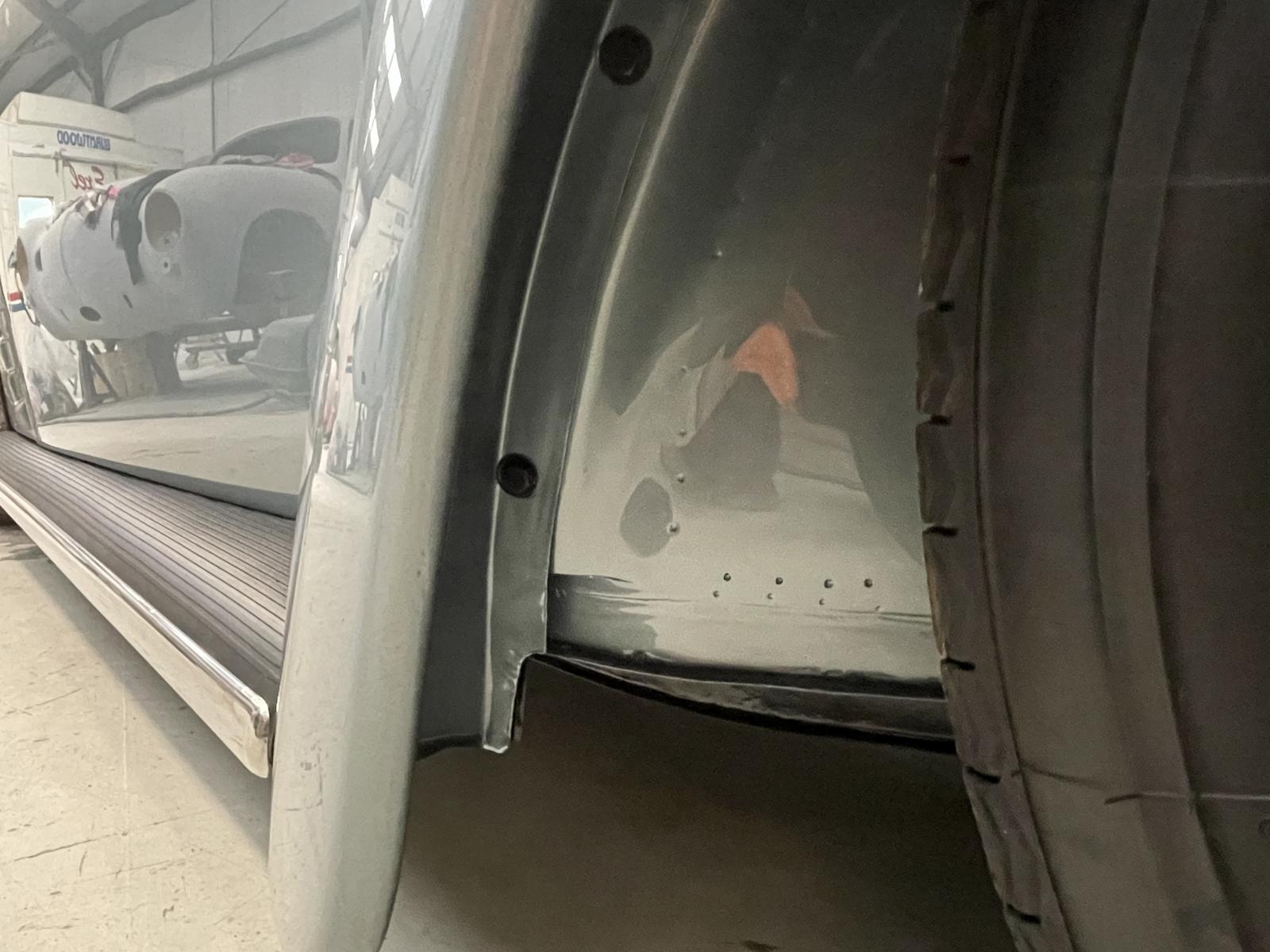

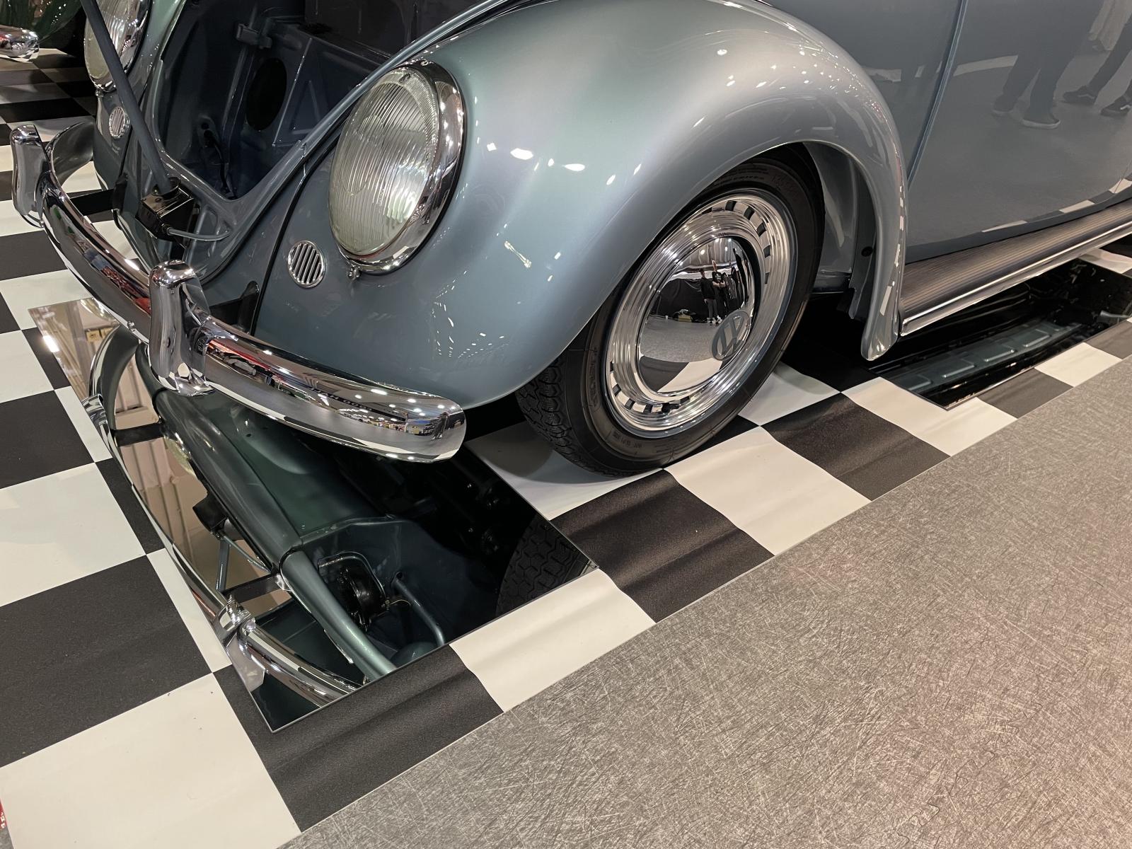

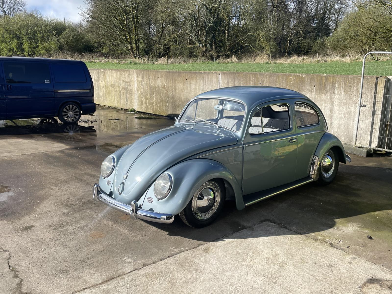

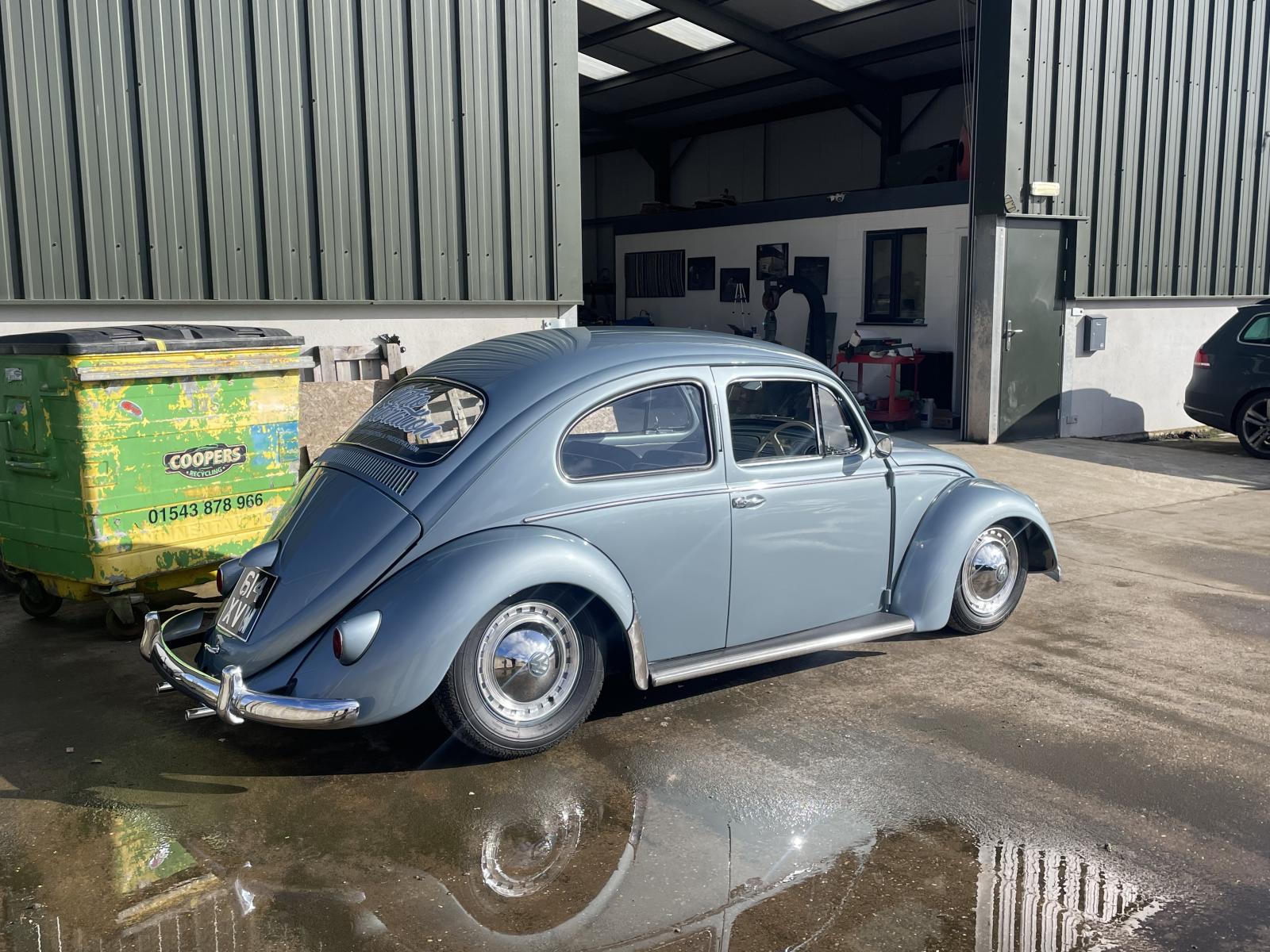

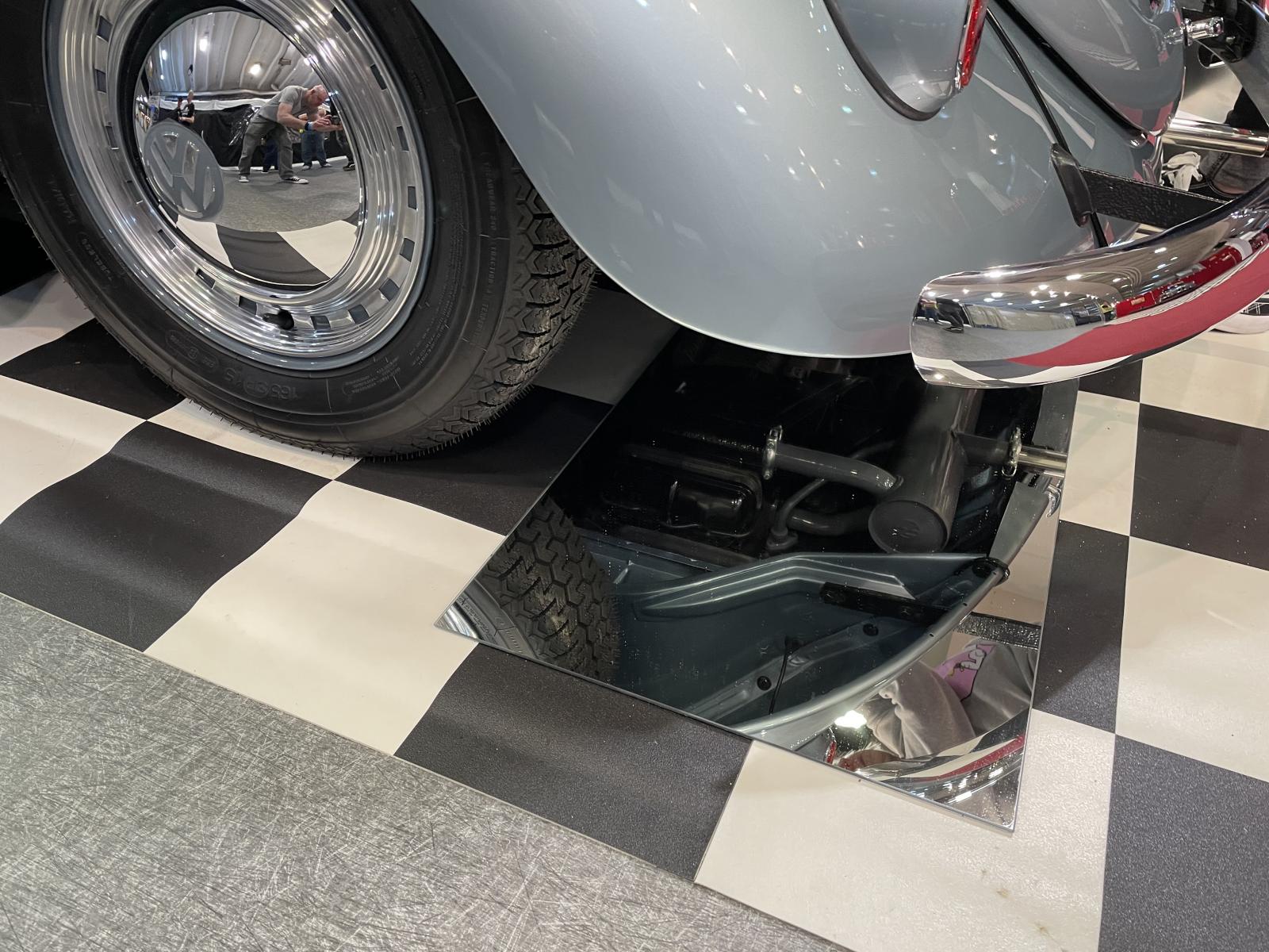

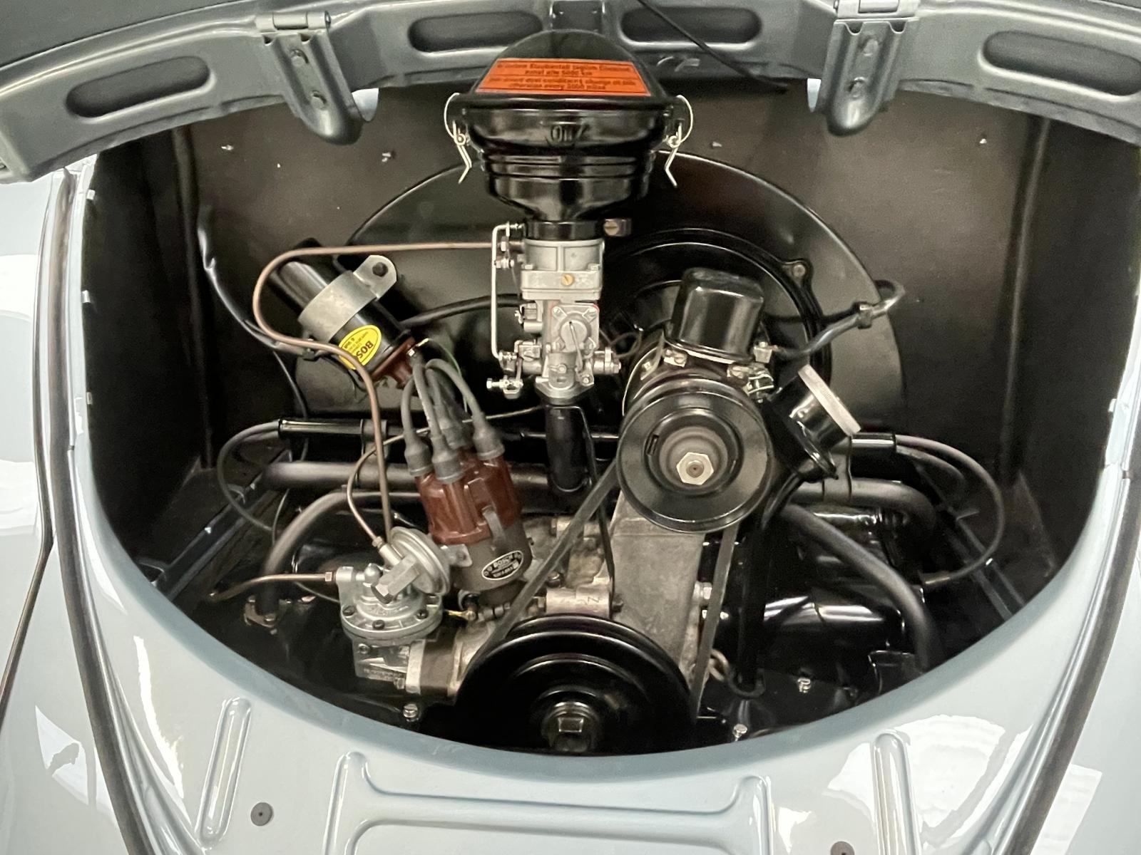

Thanks for any advice. Random pictures of my 58 Beetle I built in case any of you are interested:

What a beautiful VW bug! Welcome to the World. (IMG:style_emoticons/default/welcome.png) Take your time and search for a clean chassis. If it were me, I would be searching '73 & '74. That way you avoid the big bumpers you do not desire and you get the side-shift transaxle.
