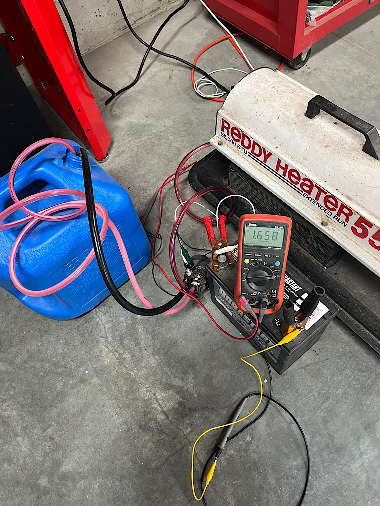

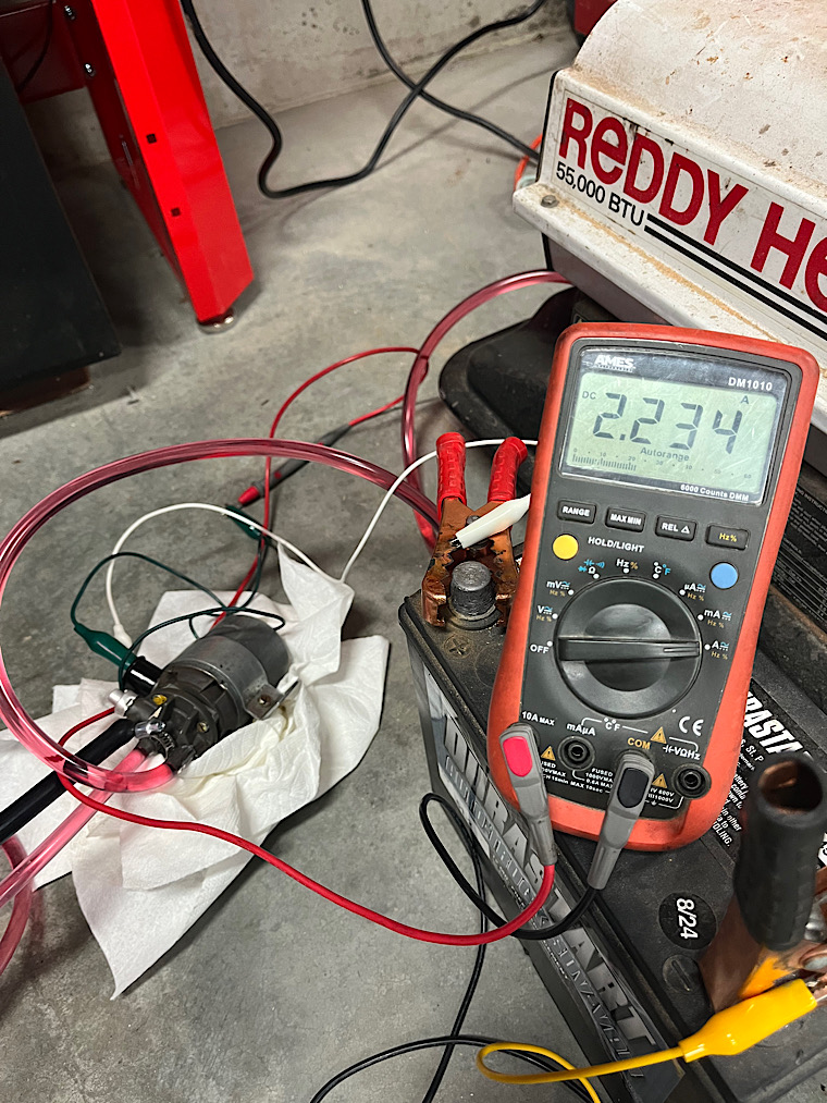

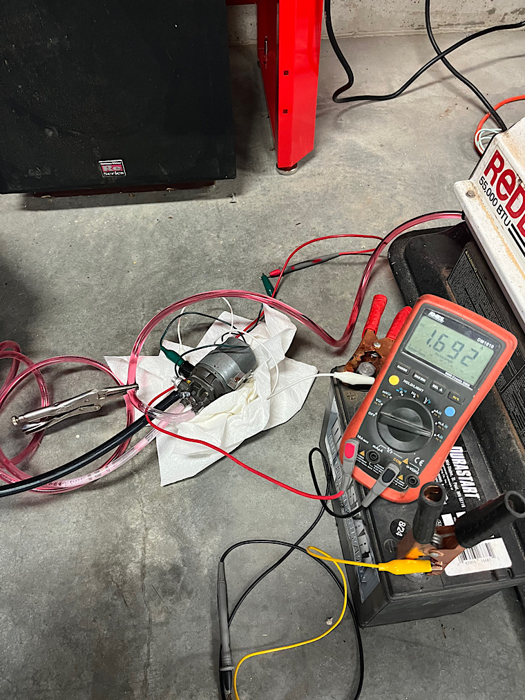

Superhawk996   Sorry for sloppy test setup. Here are the curren...   Sep 27 2026, 06:48 PM
nmkimosabe   Sorry for sloppy test setup. Here are the curre...   Sep 28 2026, 11:39 AM
Superhawk996   Impressive....as they say "a picture is wor...   Sep 28 2026, 01:28 PM
wonkipop   i pretty much agree with @Superhawk996 . the co...   Sep 28 2026, 02:35 PM
Superhawk996   Good point on the fuel lines - sometimes I assume ...   Sep 28 2026, 06:47 PM
wonkipop   Good point on the fuel lines - sometimes I assume...   Sep 28 2026, 07:15 PM
wonkipop   double post for some reason, deleted,   Sep 28 2026, 07:15 PM
