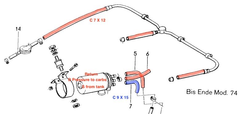

Is the only 9 mm ID fuel hose between the fuel tank and the fuel pump? The hose to the fuel rail and between the carbs is 7 mm ID?
Best I can tell from the parts catalog, this is the case. Though the hose between the fuel rail isn't given a part number. Nor is the hose on the carbs.
It is counterintuitive to me that you'd supply the fuel pump with 9mm, then reduce the size that' delivering to the carbs to 7mm.
Thanks.
