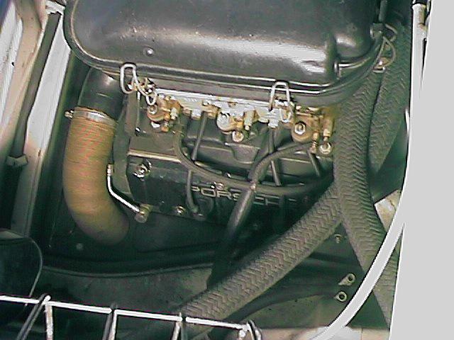

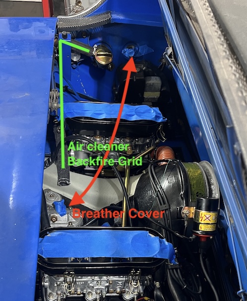

I am having trouble finding photos of where these hoses terminate.
1. Does the one that branches off the oil filler neck go to the T / backfire grid on the air cleaner? No clamp at the air cleaner end?
2. Does the one above the relay panel go to the case breather lid? No clamp at the case lid end?
Thank you.
a71914
post Aug 17 2026, 07:26 AM
Posts: 27
Joined: 17-September 03
From: Sterling, MA
Member No.: 1,171
QUOTE(DennisV @ Aug 16 2026, 10:08 PM) *
Thank you.
Hose off the oil filler neck goes to the case breather lid.
Hose over the relay panel goes to the air cleaner or oil catch can.

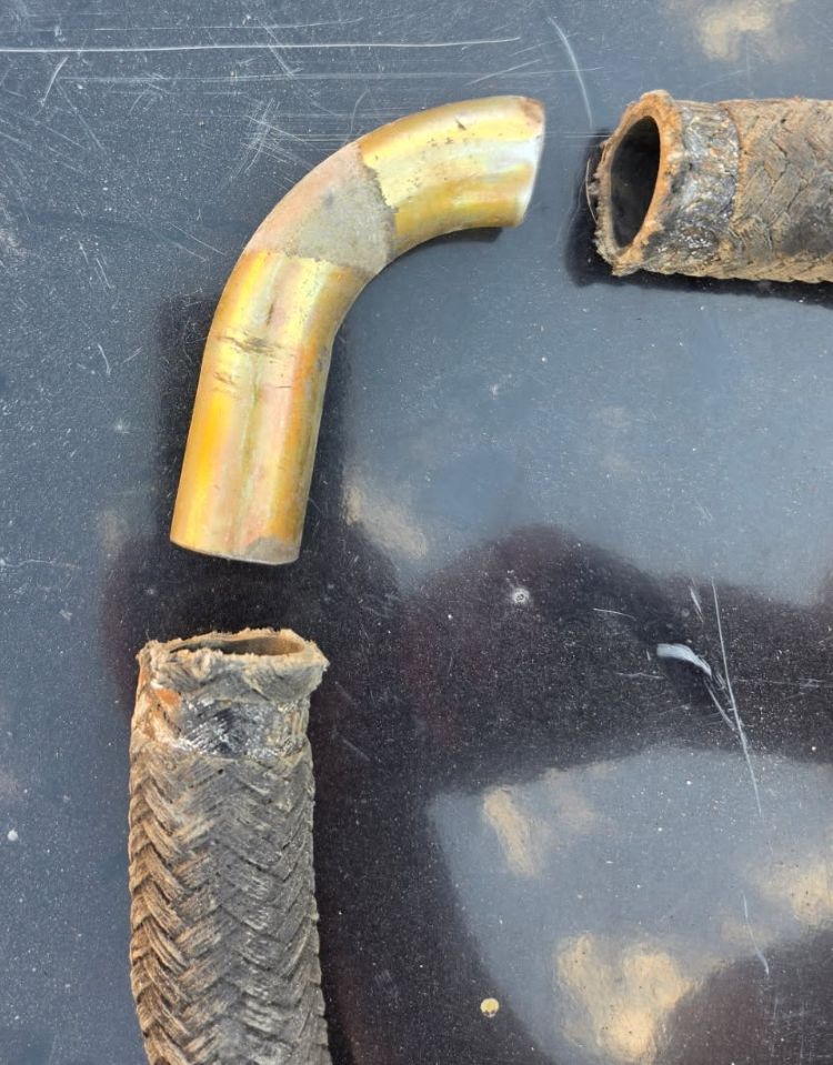

https://www.pelicanparts.com/914/914-6_cons...l_line_bend.JPG
sixnotfour
post Aug 17 2026, 12:03 PM
Posts: 11,320
Joined: 12-September 04
Member No.: 2,744

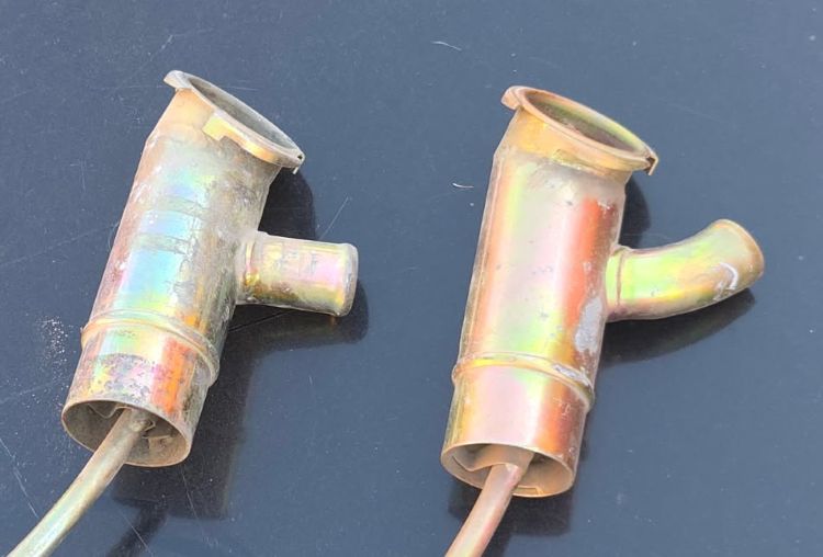

56 yr old.. 90 not a 90.. manipulated..

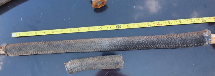

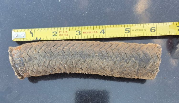

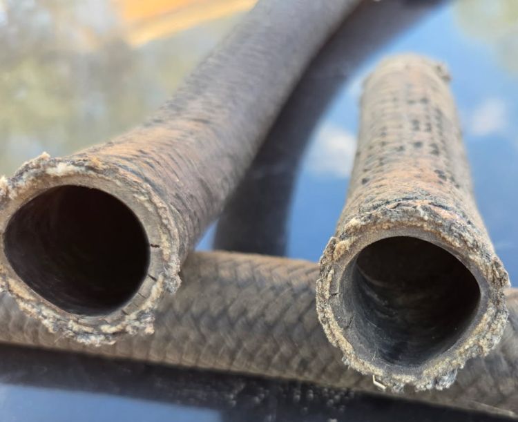

sixnotfour
post Aug 17 2026, 12:12 PM
Posts: 11,320
Member No.: 2,744
sixnotfour
post Aug 17 2026, 12:16 PM
Posts: 11,320
Member No.: 2,744
Hose ends notice the amount of push on... and distortion.that makes the weird angle.. Bonus both styles of fillers/vents..
