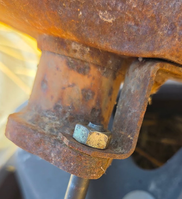

What have you found or fabricated to tighten the 13 ATF hex nut on 914-6 heat exchanger passenger side? I think that's cylinder number 1.
I'm sure this is probably mechanics 101, but I'm having a hard time with it. I've tried every combination of 1/4 socket, u-joint, wobble extender, flex driver I can find. No room for a box or open end wrench as 2 sides are blocked by bracket and pipe. Nothing I've tried provides enough engagement to properly tighten it.

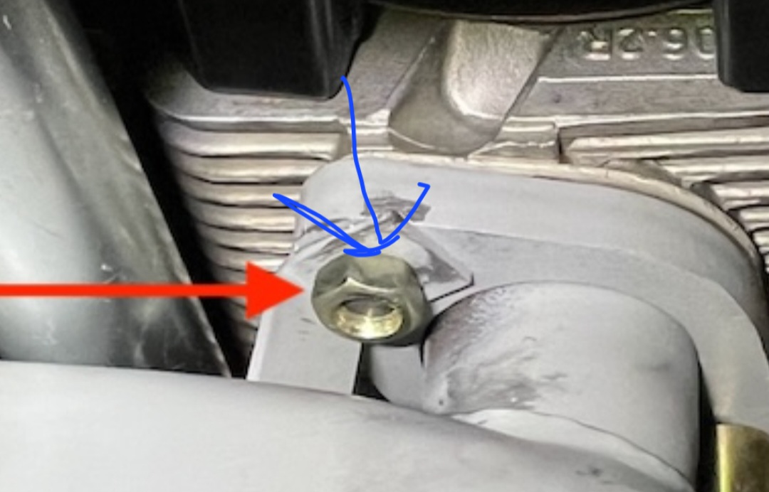

sixnotfour   The support strap needs the hole slotted so it can...   Aug 20 2026, 12:14 PM
Superhawk996   and your studs short.. :agree: Thats going to f...   Aug 20 2026, 01:16 PM
porschetub   and your studs short.. :agree: Thats going to ...   Aug 20 2026, 04:40 PM
fixer34   Want to say I used a ratcheting box end, swivel he...   Aug 20 2026, 05:38 PM
mepstein   Yea, unless that’s some sort of optical illusion...   Aug 20 2026, 06:23 PM

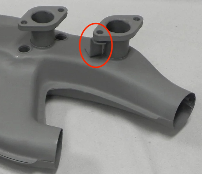

bdstone914   @[url=http://www.914world.com/bbs2/index.php?showu...   Aug 22 2026, 09:50 PM
DennisV   Why is the piece of metal under the nut? I can...   Aug 23 2026, 08:07 AM
mepstein   Why is the piece of metal under the nut? I can...   Aug 23 2026, 08:47 AM
Steve   [quote name='DennisV' post='3269391' date='Aug 23...   Aug 23 2026, 12:22 PM
sixnotfour   Dansks version of the bracket... is the odity. Rus...   Aug 23 2026, 02:43 PM
DennisV   Dansks version of the bracket... is the odity. C...   Aug 24 2026, 09:39 AM

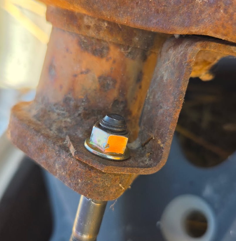

DennisV   As a follow-up for anyone else that heads down thi...   Nov 13 2026, 09:19 AM
