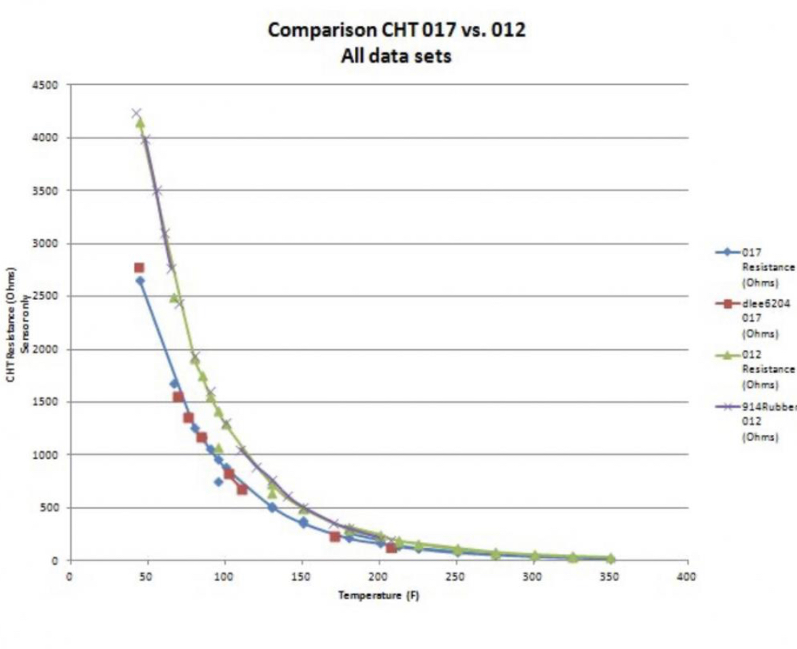

Check cylinder head temp sensor resistance both hot and cold. A 1.8L would be using the 012 sensor.

Temp sensors. Check them.
