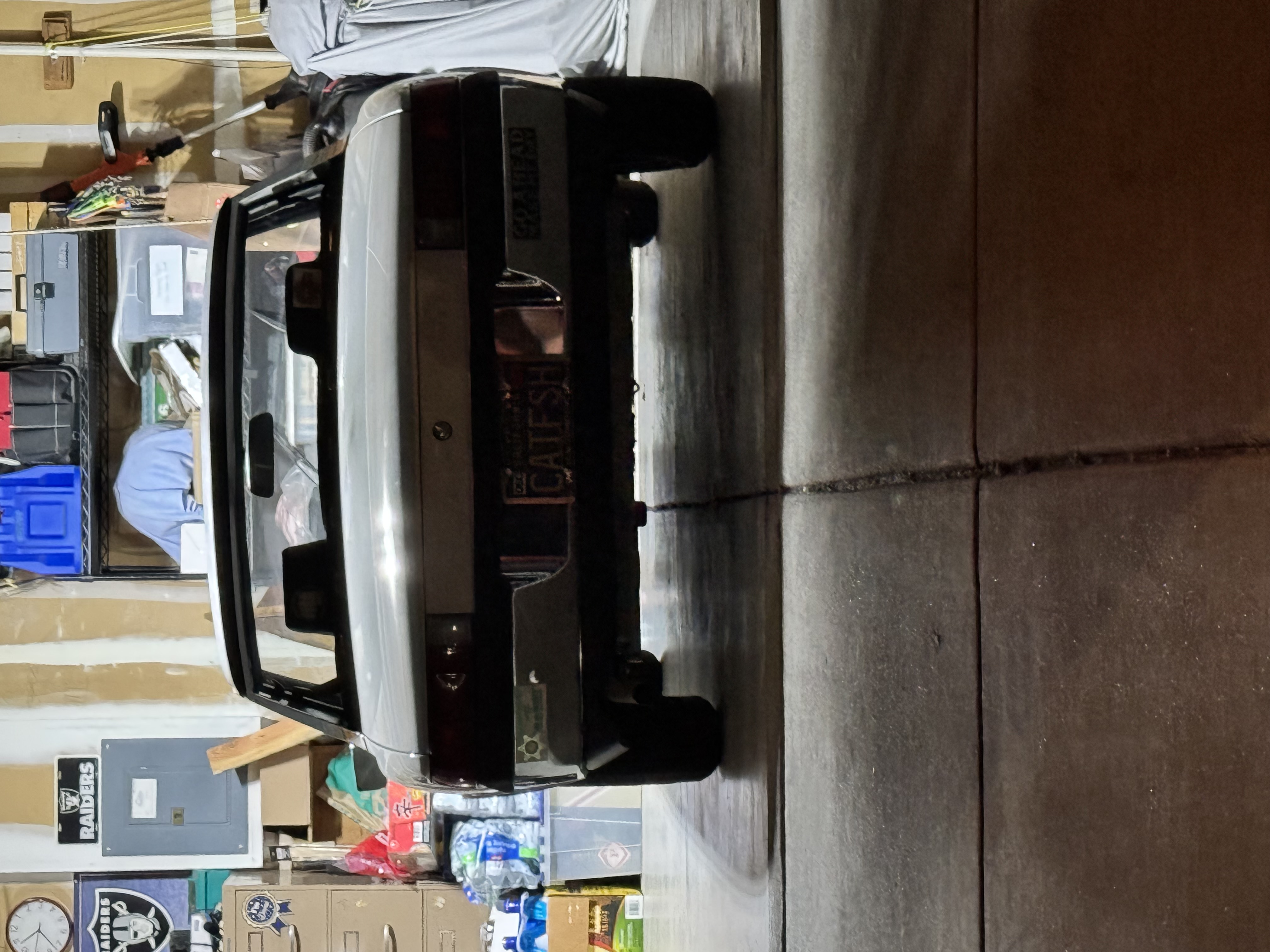

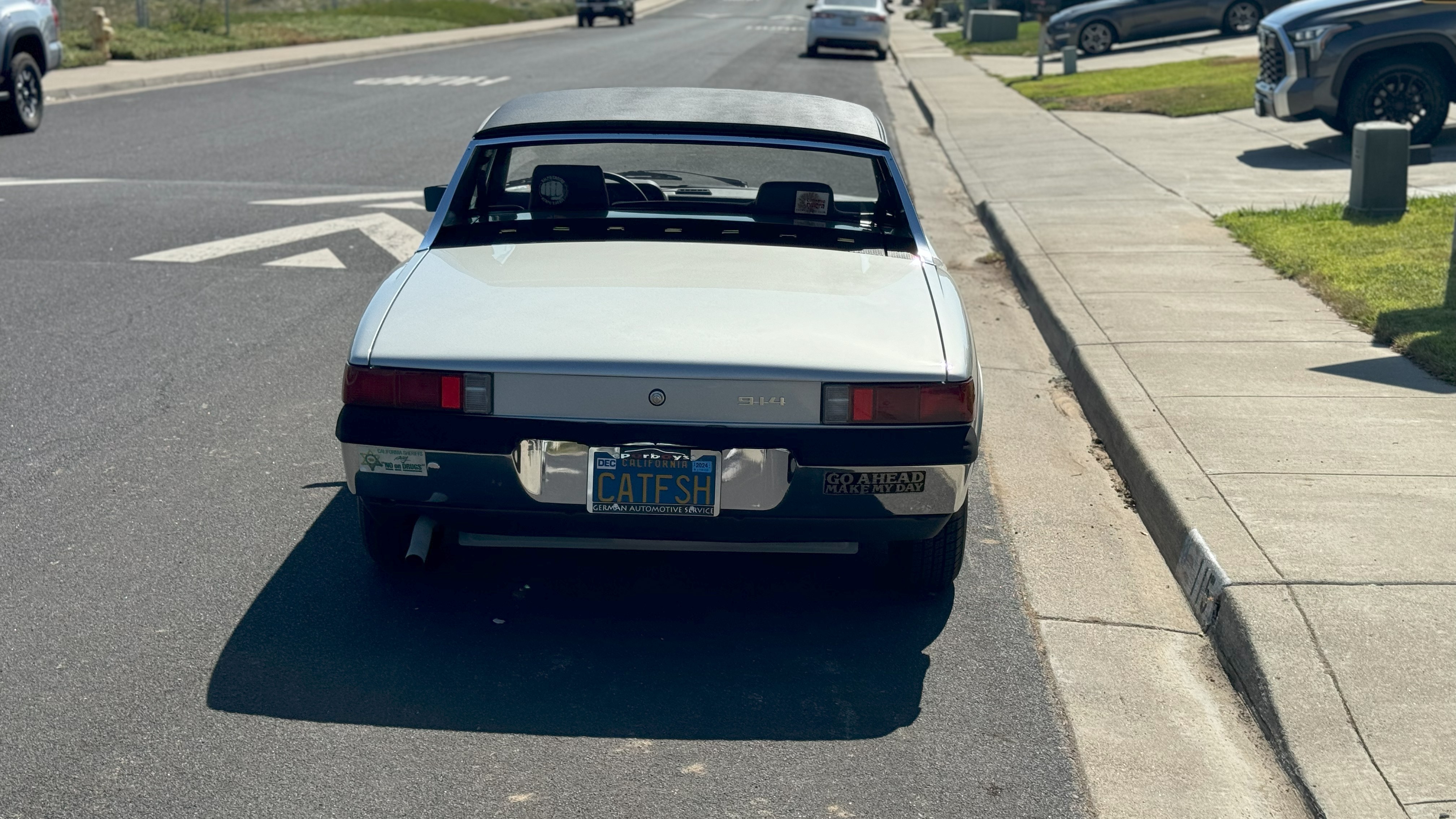

My recently "partially restored" 914-4 seems to have a noticeable lean. I checked the distance from the ground to the wheel-well all around and this is what I got:
Front Passenger/Right: 26"
Rear Passenger/Right: 23.5"
Front Driver's Side/Left: 25"
Rear Driver's Side/Left: 22.5"
I don't know what's "normal" for 914's but I'm wondering if I should be worried? I want to do more work to the car (electrical, shifting) but I feel like this needs to get sorted out first. I checked some pics from 2024 to compare and it looks like it might have been like this for a while so not sure why it seems much more noticeable now.
Any advice/thoughts/suggestions?
Quick History:
My late dad was the original owner. It was his daily driver for many years and then garaged for many years after he retired. At some point he passed it along to me. I'm not aware of any major body damage. I've heard stories of it being involved in an accident in the early 70's but I don't have any details.
I like to tinker but I'm no mechanic and I don't know much about 914's. In early 2020's I started a restoration project with a local shop - body (remove rust and dents), fresh paint, rebuilt engine, new exhaust, refresh interior ... spent more than I should have but got it looking pretty and back on the road. Brought it home summer of 2024. I've driven it maybe 100 miles in 2 years.
Aug 2026 .... sorry about the orientation

1 inch lean is significant. First thing i would check is if a rear suspension console is cracked or any issue with the trailing arm. May be difficult to see without a lift.
I would measure the ride height from the bottom of the rocker panels to the ground, front and rear.
Did you just notice the lean ?
What kind of rear shocks and springs? Could be a rear spring sagging. But they usually gag equally.
Maybe a local experienced member can help you check it out.

My worry was that I might be discovering some kind of warp in the unibody. When I looked at the 2024 pictures, I noticed that the driver's side tail light is closer to the bumper than the passenger's side which is what got me wondering. If that WAS the case, I was thinking I should halt any more work until that gets worked out. But if this is just a "suspension" issue, that's a relief and something I can deal with. And maybe that difference in gap between the tail light and the bumper between the right and left side is nothing to worry about.
Yeah, I'm a big-ish guy ... 250+. I typically drive solo although my wife (she's definitely lighter than me) has threatened to steal the keys a few times.
Looking at the numbers I posted earlier, and ignoring the lean, the difference in height between the front and back is consistently 3". Is that typical?
As for the entire length of Driver's side being 1" lower than the entire length of the Passenger's side - I'll put it up on the QuickJacks to see what I can find ... not exactly sure what I'm looking for but maybe something will be obvious.
