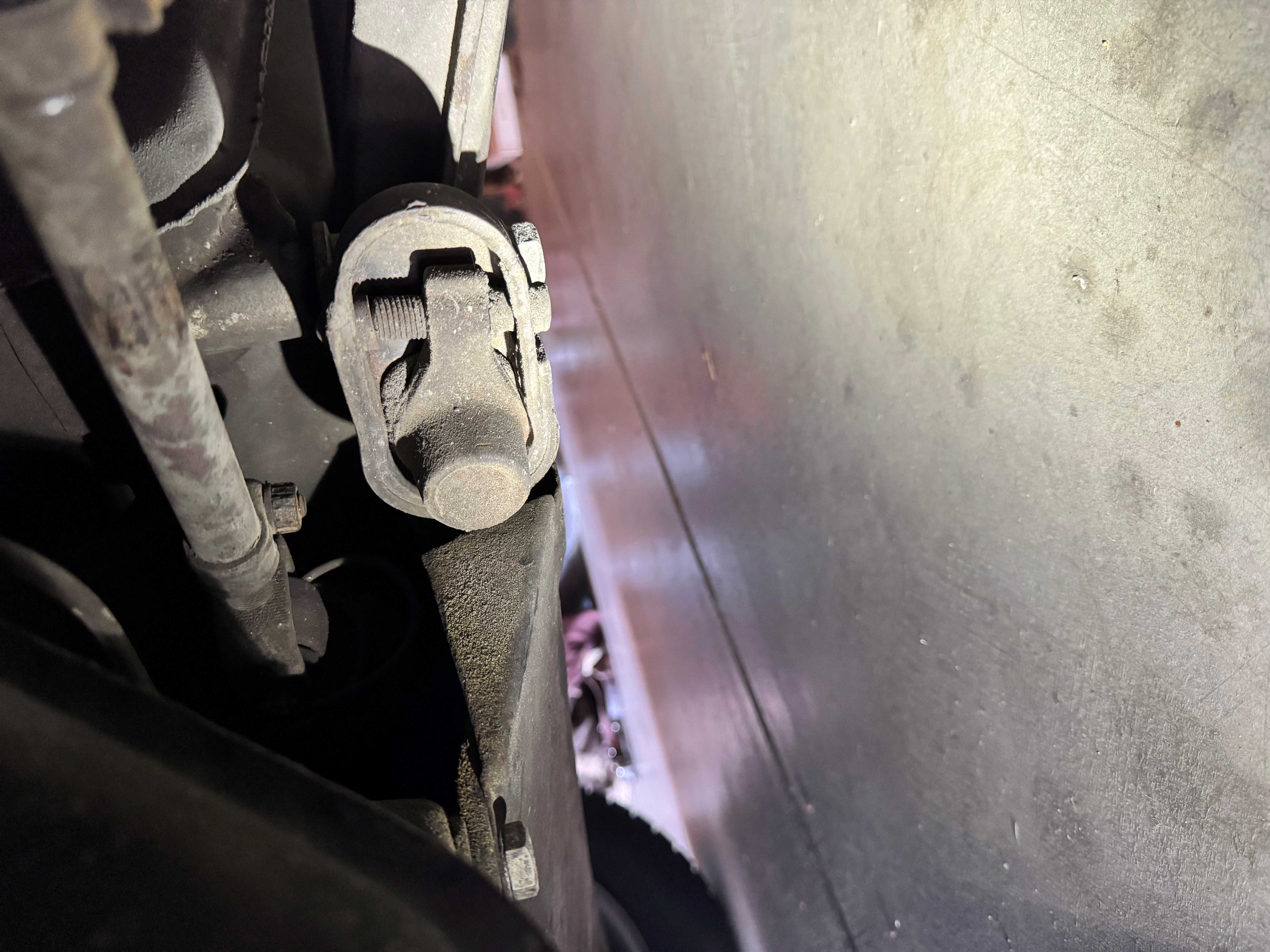

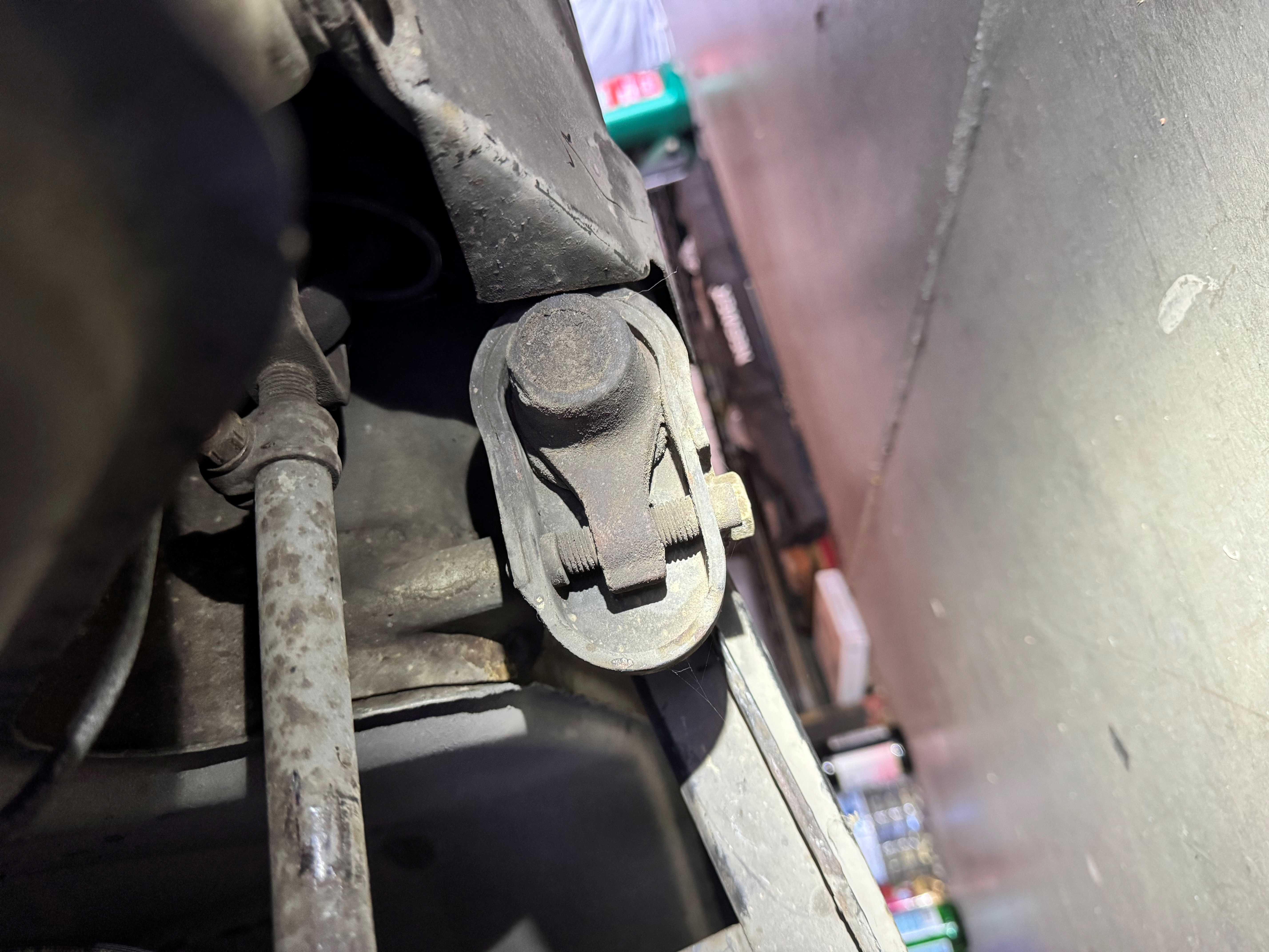

Thanks @Superhawk996 & @930cabman . I appreciate your insight. I've been trying to educate myself on what the Torsion Bars are and how they work. I didn't try adjusting them but I took a pic of their current positions. The Driver's side is about in the middle. But looks like the passenger's side is almost bottomed out which, if I'm understanding correctly, means it is almost adjusted as low as it can go (without reindexing as @Cairo94507 mentioned)?
Passenger's Side
Driver's Side

You have plenty of torsion bar adjustment to play with and to get a feel for if you’re going to have to reindex anything.
Your passenger side is near max height so you’ll be loosening that one to lower that side. Driver side is low so you’ll be tightening (bolt clockwise).
Spray a day in advance with penetrating oil to make life easier.
Tightening raises.
Loosening lowers.
Take weight off the wheel when adjusting and never get under car without jackstands in place. (You said you don’t wrench much so forgive me if I’m reinforcing safety)

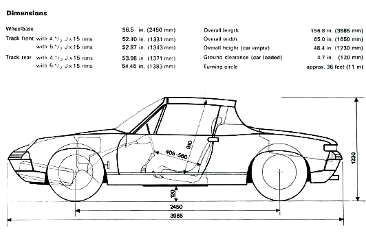

BTW - Found this image at the site below ... does that say 4.7" (120mm) from the chassis (car loaded)? Wow.
https://www.p914.org/p914_dimensions.htm
