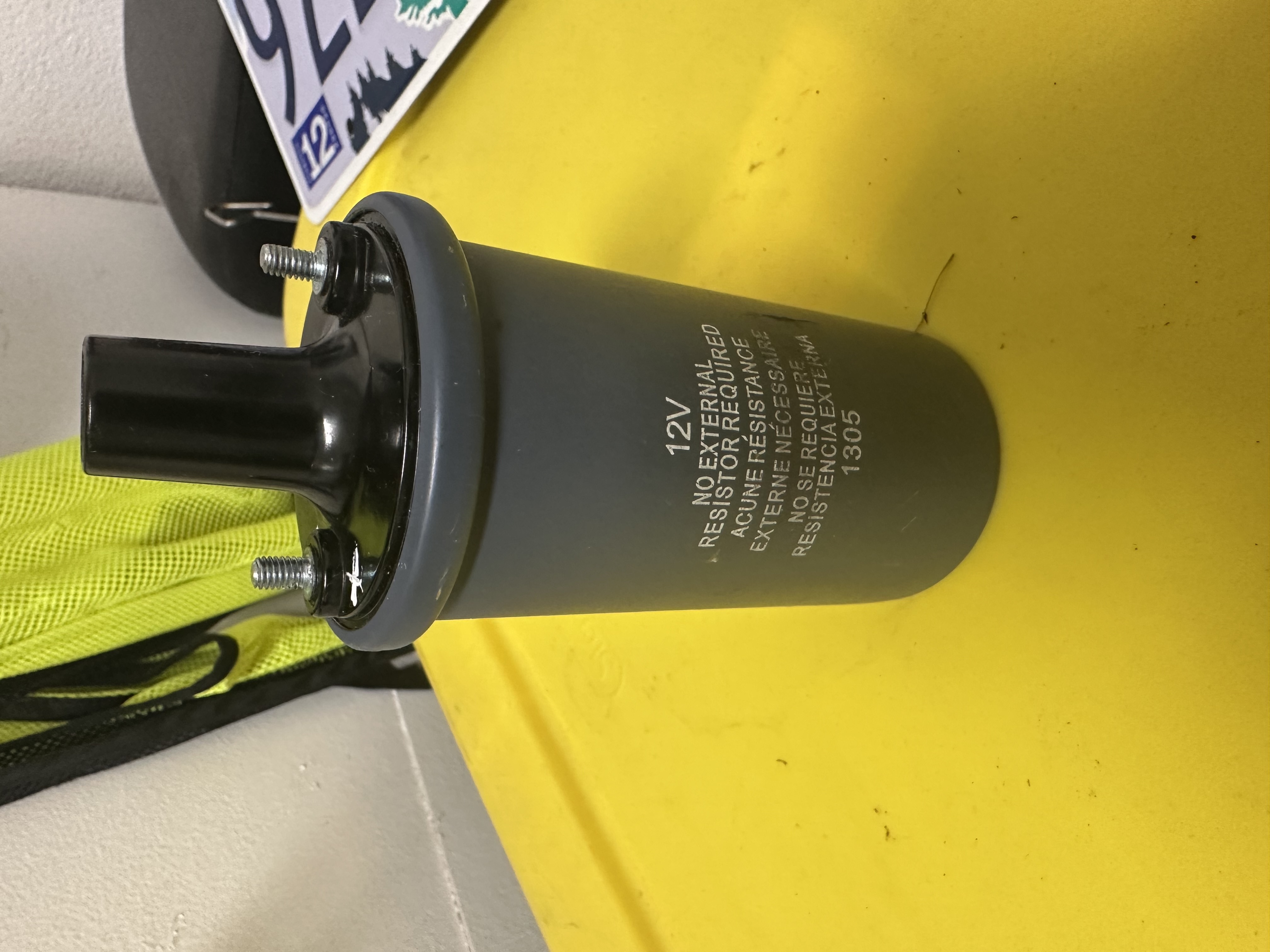

Here is picture of old coil. No name on it. Yes, car running good now, just like to know what caused the coil to go bad. Thanks for all the info so far!Attached Image

Check the resistance across the secondary and primary coils and post them. I am curious. Did you check the connectors on the wires going to the coil? They get brittle and just swapping might have 'fixed' it for the time being.
I have heard some oil based coils don't like to be mounted sideways.
