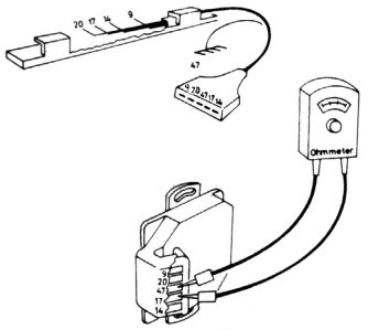

did you check the correct electrical function of the TPS?
It has to be adjusted not only on the bench, but on the throttle, too.
Check the continuity between the pins 17 and 47 with the throttle closed.
They have to be 'zero resistance'.
If you have no continuity, loosen the two screws of the TPS and turn it a little bit counter-clockwise until you can feel some resistance.
Fasten it in this position and check the continuity again.
If you still have no continuity, something in the TPS is wrong.
If you have found no problems at the TPS, you might have a problem with the harness.

Yeah, check your adjustment. I have ended up adjusting them on the car for just this problem. Use a multimeter and make sure that last wire closest to the passenger is responding to the idle position.
