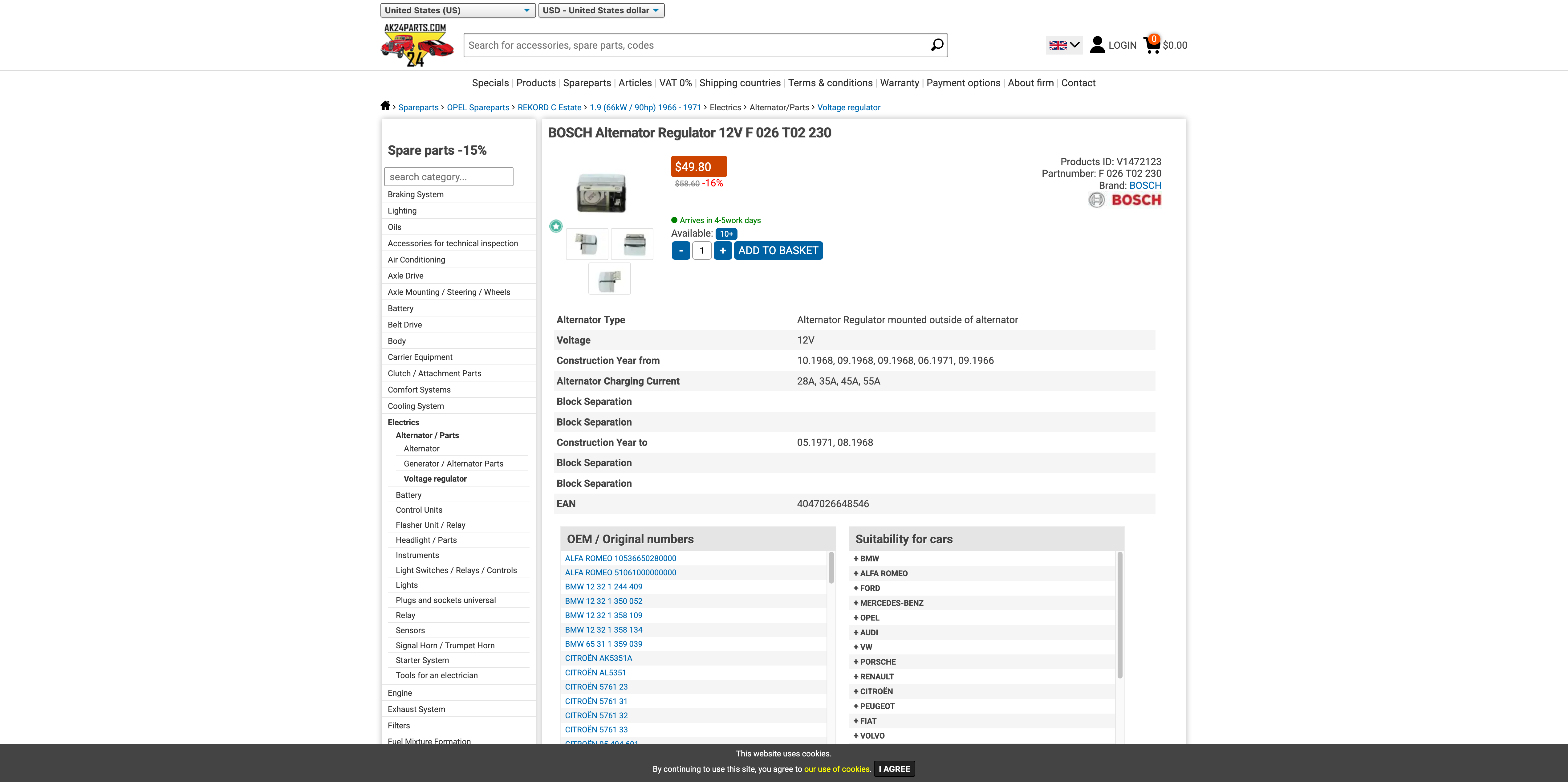

Here you go >Real Bosch. Only place I know you can get them now. Shows listing for Opel but don't worry. $50 plus shipping then import tax. Click to open .
