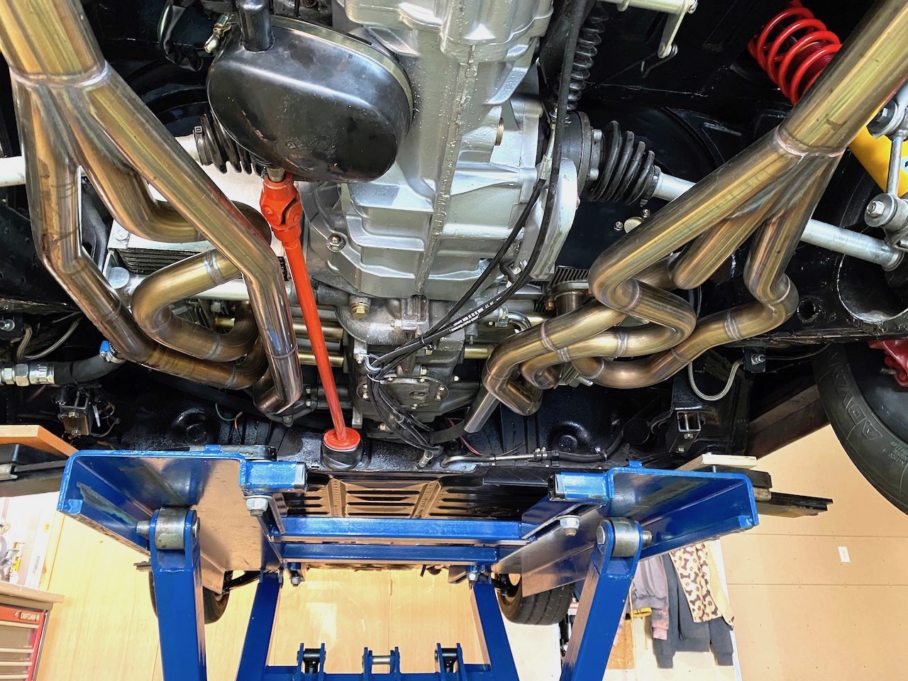

Yes, I running a 901 side shift with short gears from a 2.2 S with PMOs and Ben's headers. Love it.Attached Image
