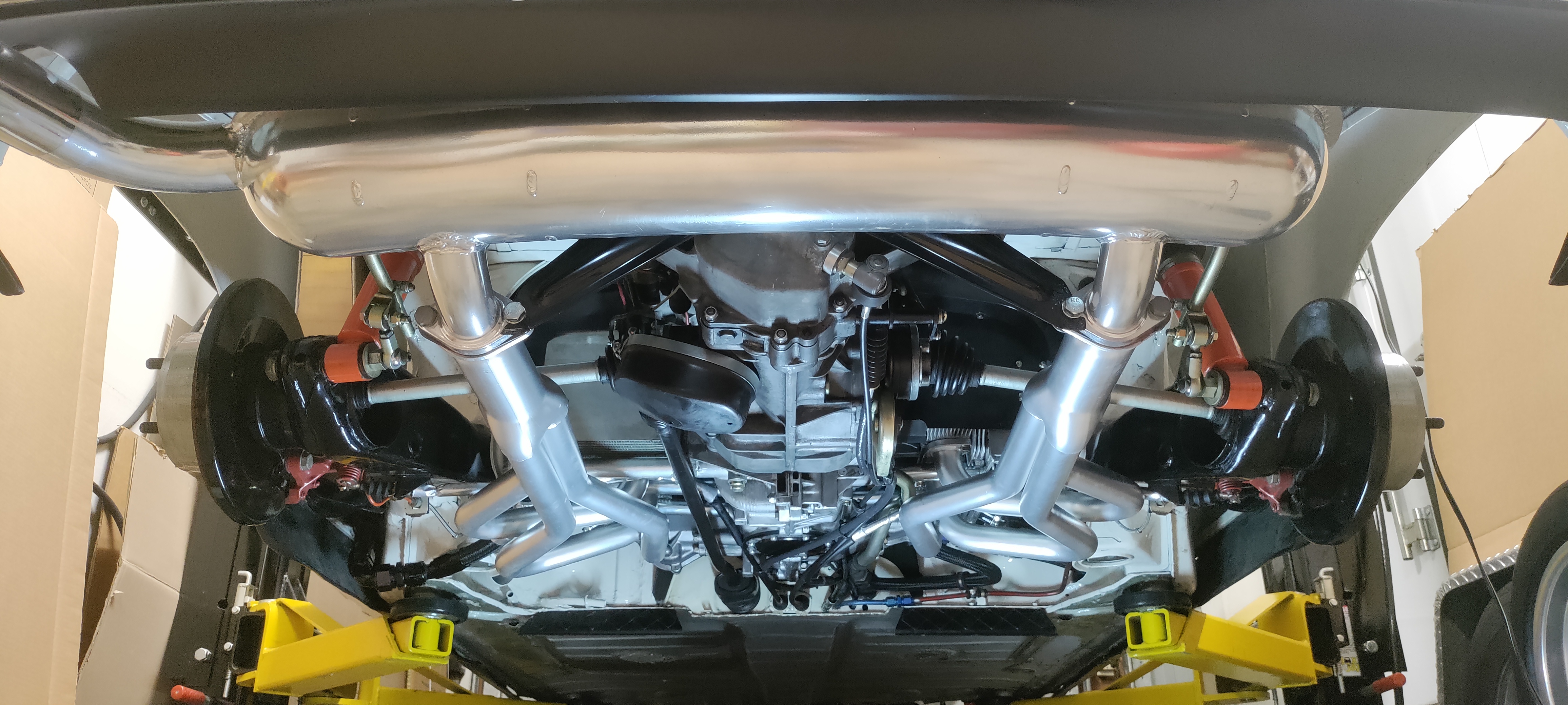

I've had my 914-6 GT Tribute for 13 years now, on the road since 2018, and I never get tired of seeing my MSDS headers. I consider them a key part of my build.
They are truly a work of art! (IMG:style_emoticons/default/first.gif)
I believe they look better than the ones on the BAT car, but I think it is very cool that your headers on on that car!

QUOTE(Lucky9146 @ Sep 28 2026, 09:24 PM) *
Marty
Jim>> those ceramic coated headers look 1 day old (IMG:style_emoticons/default/biggrin.gif) For the high caliber of the B-A-T car's builder, forgoing some type of coating for performance + protection from the elements was not a good choice IMHO (IMG:style_emoticons/default/dry.gif)

Just as a for what it is worth..
This is a set of headers Ralph Meaney used on his 914's back in the day.
They look pieced together..
I used these on a 2.5 years ago..
rick 918-S
