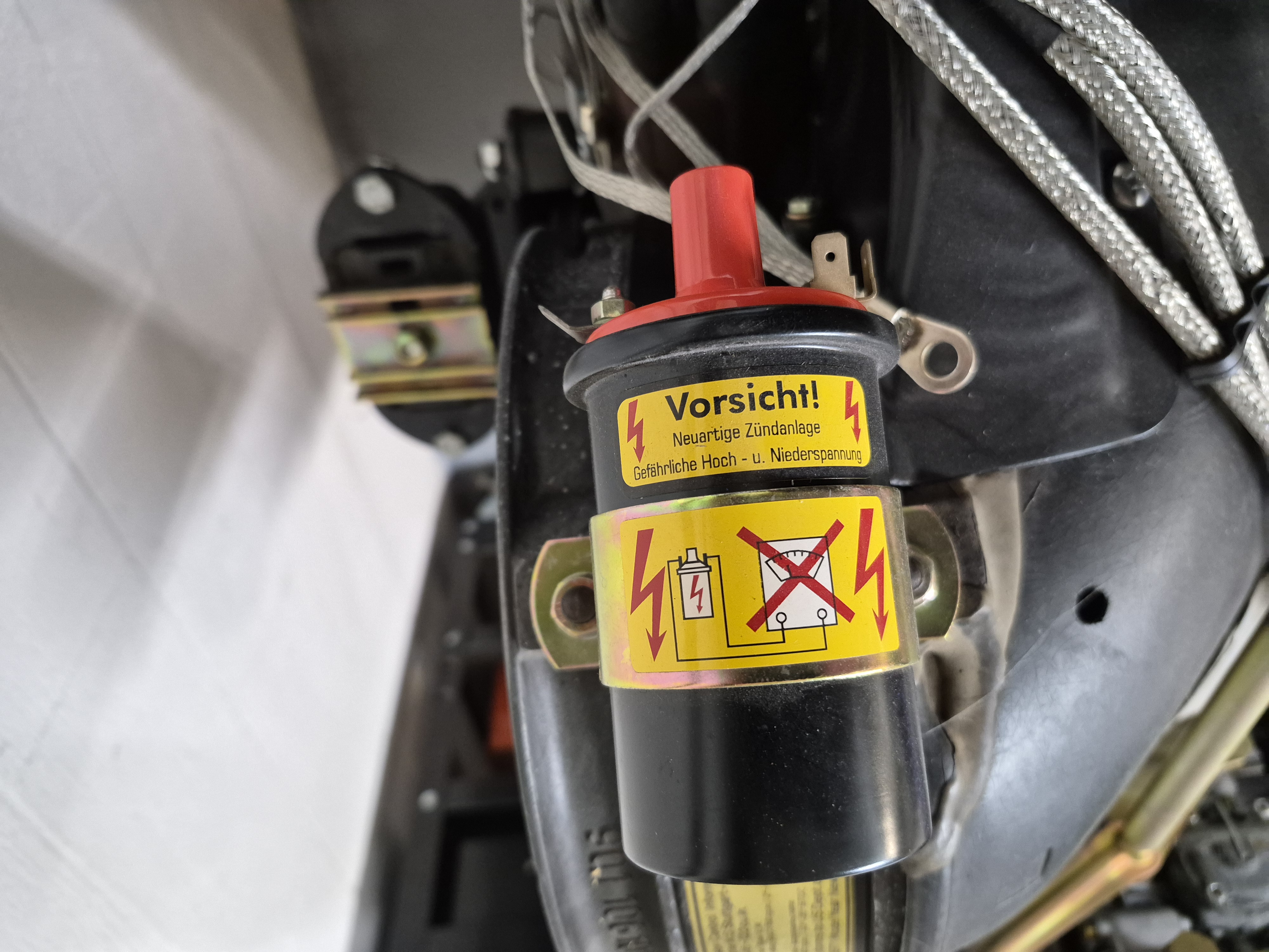

Anyone know why this warning is on the coil for a 914-6?

Possible reason...
CDI ignition systems might fry your test equipment/fingers if a capacitor discharges during testing.
I've seen warnings like this before on CDI ignition systems.

QUOTE(jrrobertson @ Sep 29 2026, 07:14 AM) *
I think that is because you need to make sure the signal is routed through the CDI. Not directly to the coil.
I destroyed a coil on my test stand because I wired ignition directly to the coil instead of through the CDI. (IMG:style_emoticons/default/excl.gif)
@Cairo94507 Aase has a good selection of decals, including coil bracket decal.
