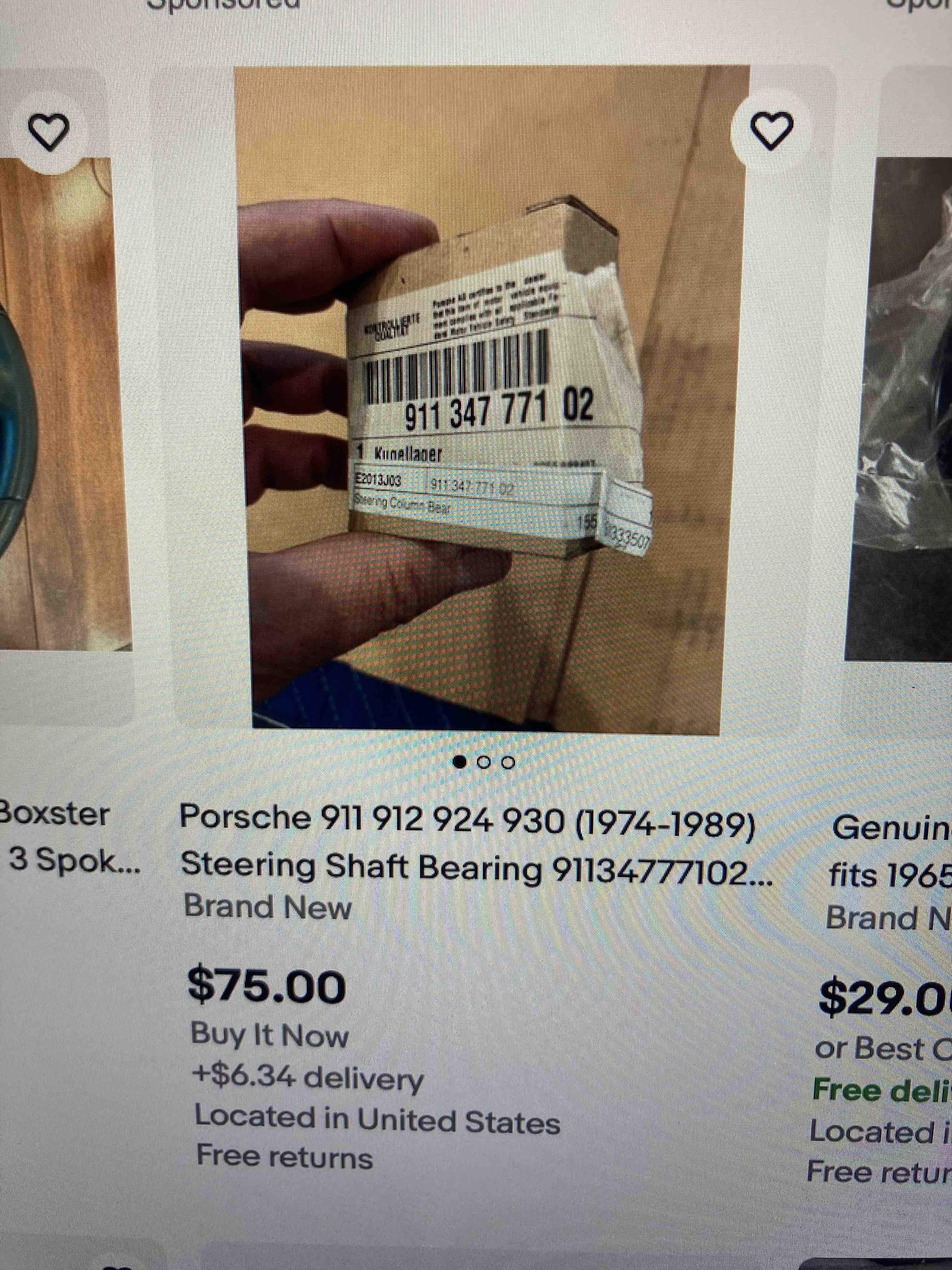

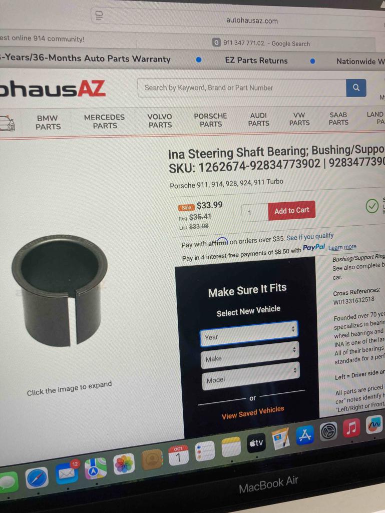

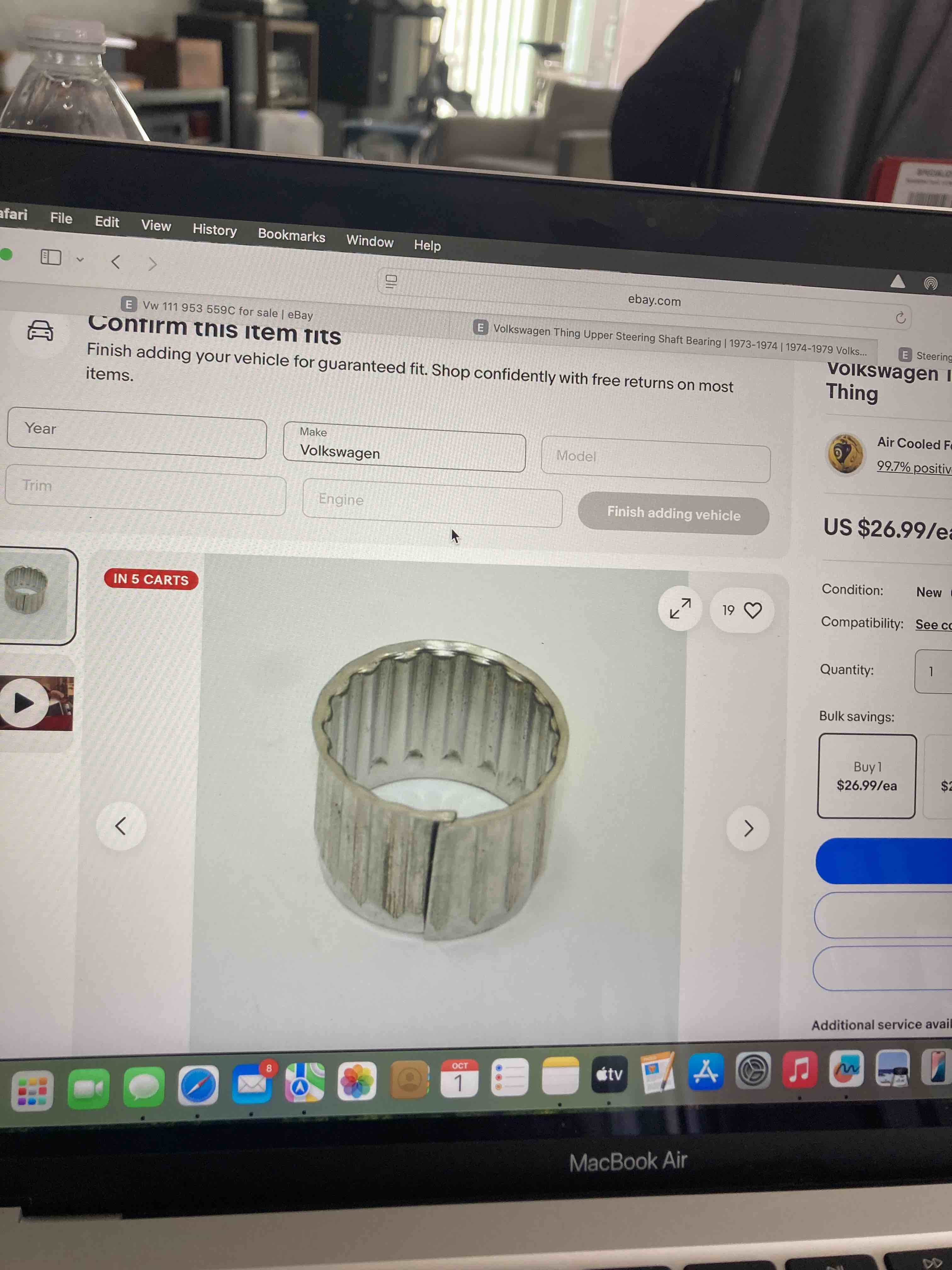

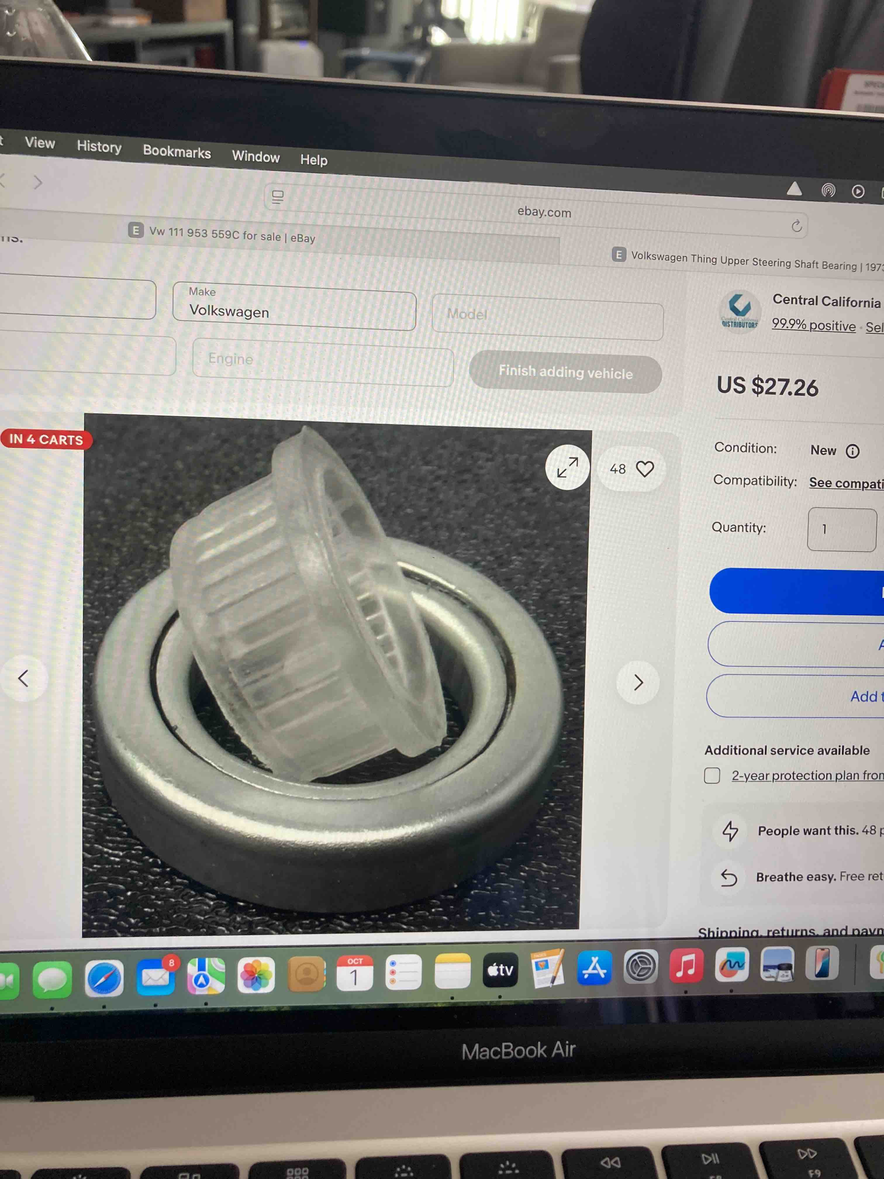

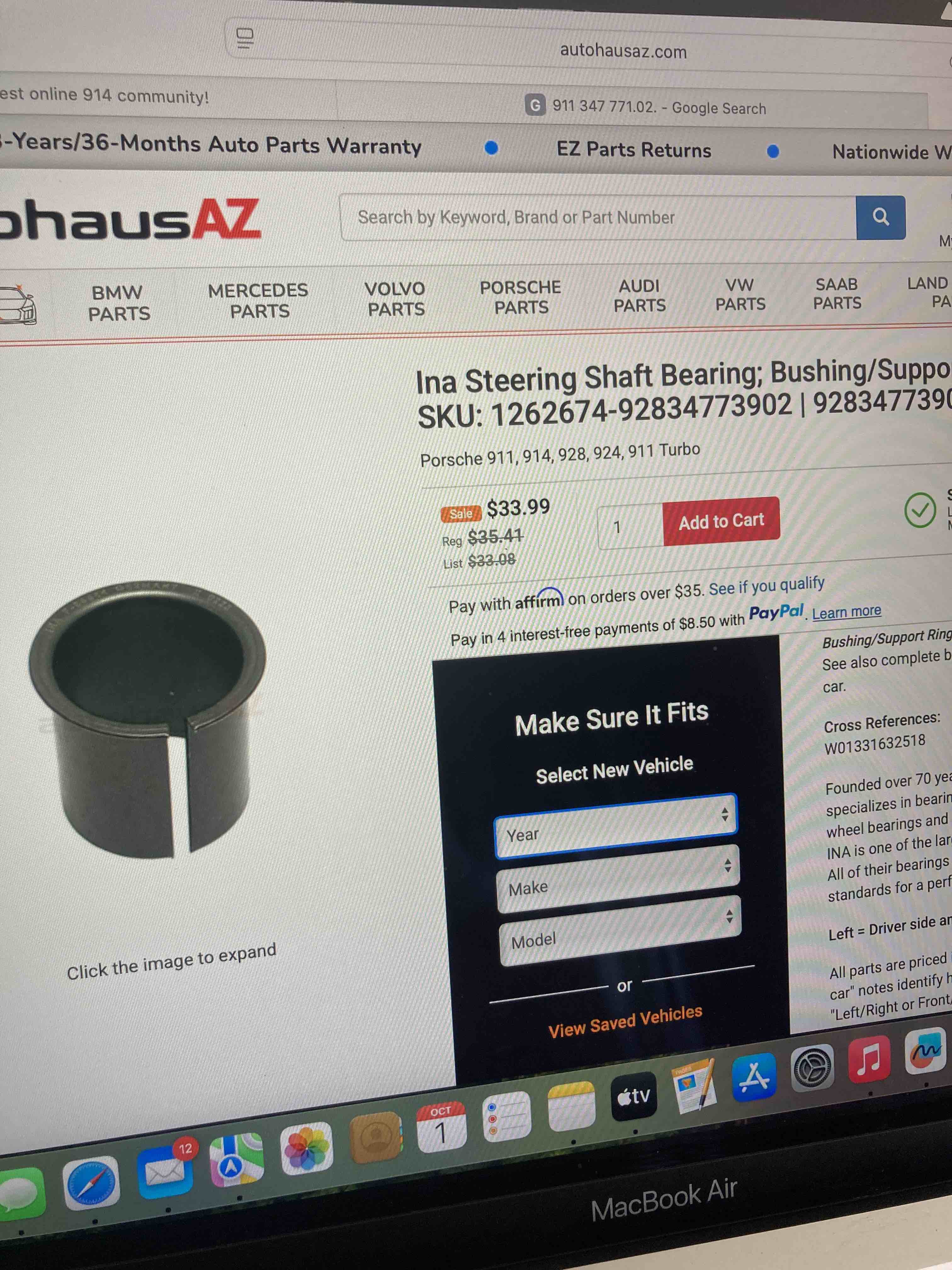

When I got my car one of the things I didn't like was if you grabbed the steering wheel
you could grip it and move it side to side or up and down . I have purchased a steering
column rebuild parts from 914 rubber but I don't believe it will address the problem I
am having . @914Sixer suggested a couple of part numbers to correct this . The cheapest
option is to replace what reminds me of the crush washer used on the shifter knob to
hold it tight to the shifter. Does anyone else have experience with this problem/repair ?
These are the parts sugested I believe.
I also ran across these parts while searching.
