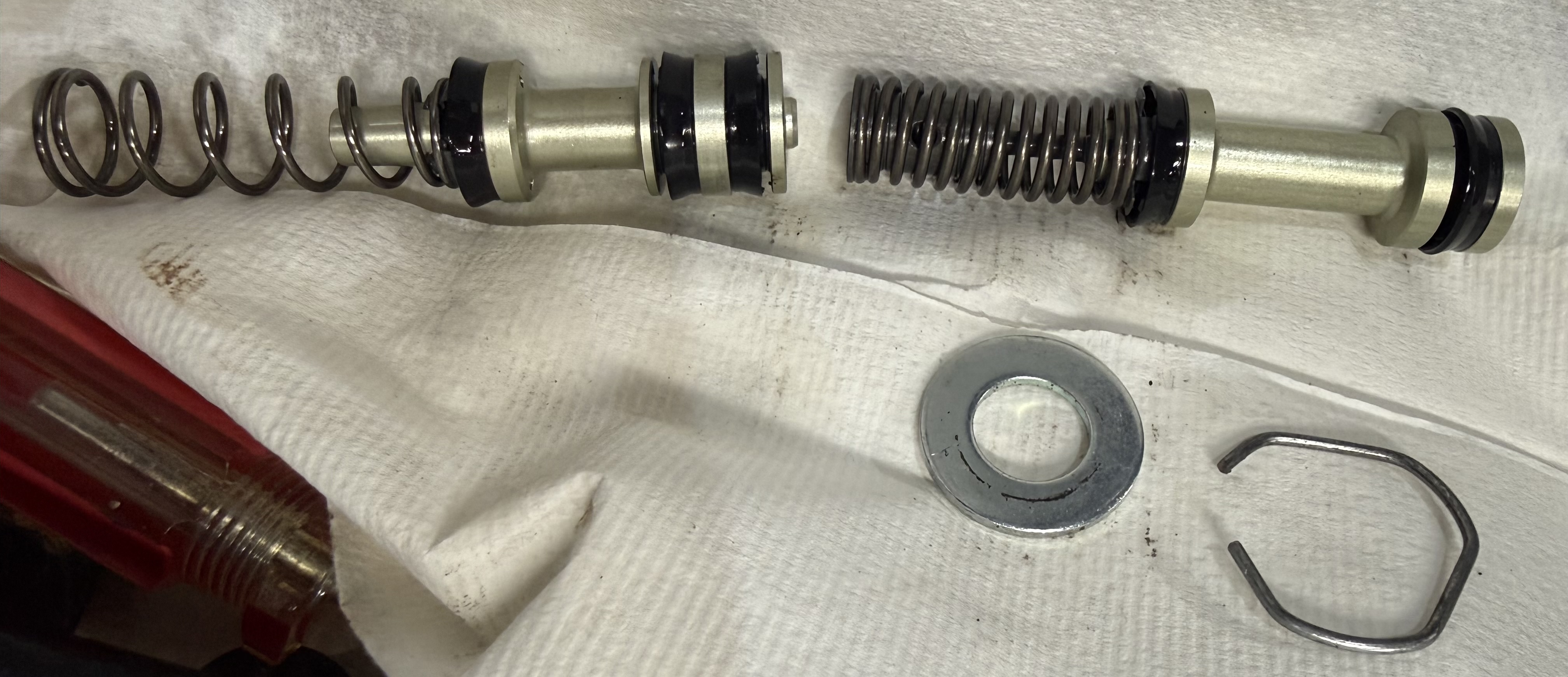

Opened up the master and the bore looks OK, some debris in there, maybe from the old rubber. I think this master has been in there since 2007 or 8. Worth rebuilding?
bdstone914
post Oct 6 2026, 10:28 PM
Post #23
bdstone914
Posts: 5,403
Joined: 8-November 03
From: Riverside CA
Member No.: 1,319
[quote name='Nana's_914' post='3274402' date='Oct 6 2026, 05:56 PM']
Yes

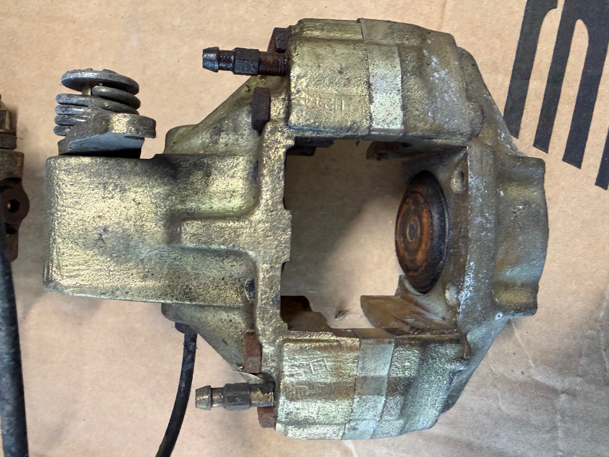

System plan so far:
Front: '78 911 SC struts with a matched pair of A calipers (48mm pistons), Sebro cross-drilled 20mm vented rotors, and soft lines that transition from 16mm on the 914 chassis tabs to 14mm on the SC strut tabs. What's the trick to adapting to the SC strut tab? 16mm-to-14mm lines, drilling the tab, or other?
Rear: The car has a PMB vented 914-6/GT rear kit, but the calipers need a refresh, and I suspect they're spaced stock calipers rather than true GT units. If they're stock 33mm, I'll think about upgrading to the 38mm GT calipers to restore the factory 914-6/911 balance with 48mm fronts.
Regulator: Rear pressure regulator calibrated by PMB for this caliper combination.
Master: Rebuild the 19mm with a Porsche kit, which matches 914-6 spec with 48mm fronts and 38mm rears, then evaluate pedal travel vs. effort. A 20.6mm stays in my back pocket if the rebuild fails or the pedal feels long.
Lines: New hard lines and braided soft lines throughout.

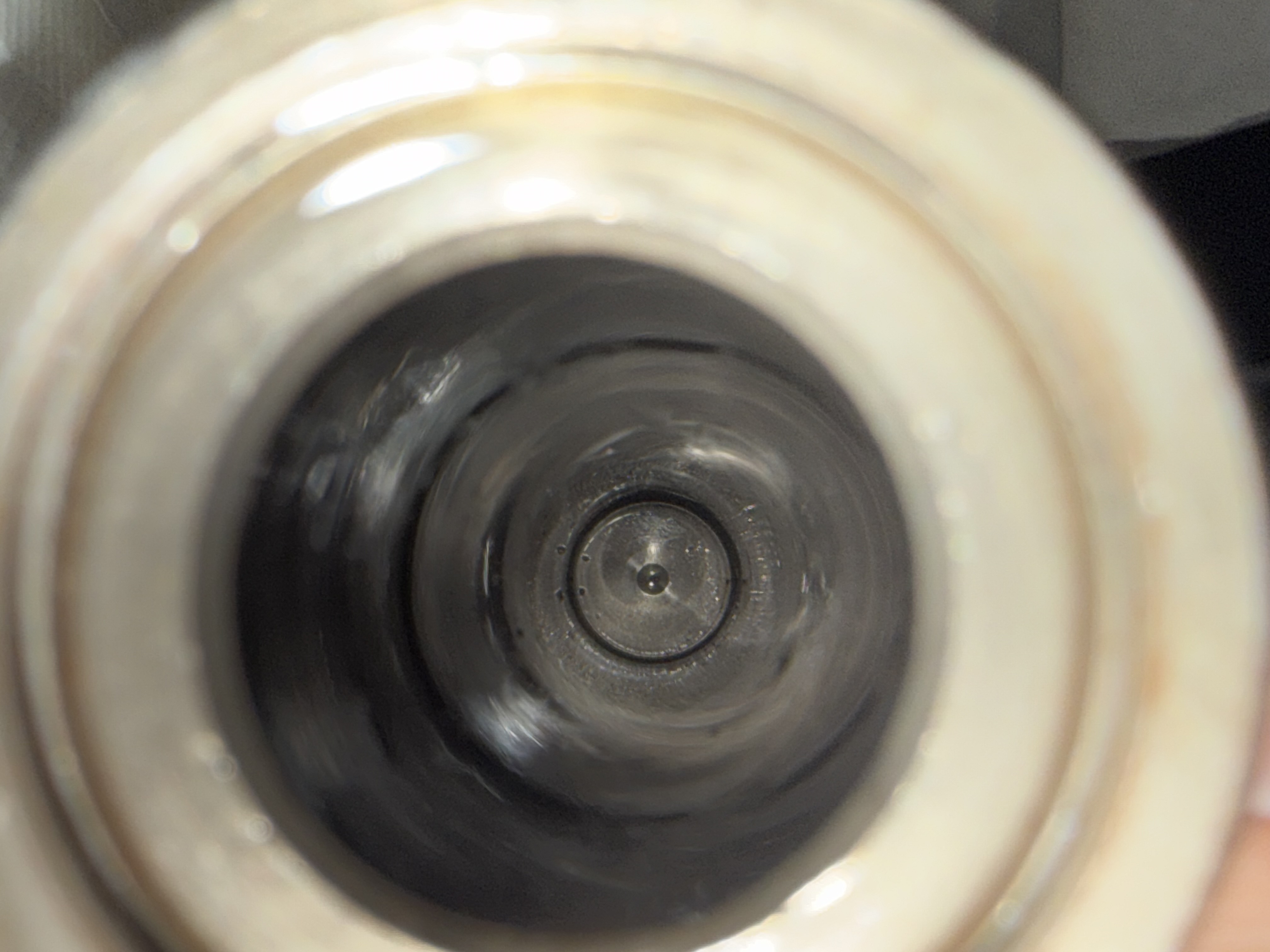

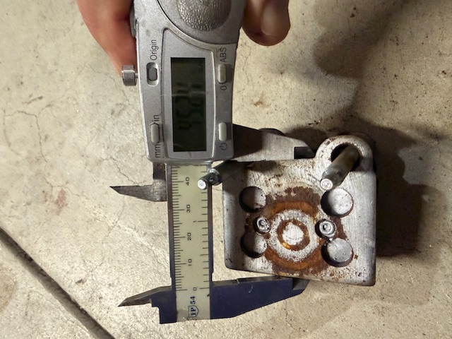

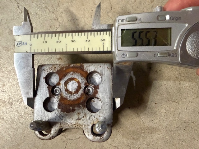

I'd like to verify the rear caliper bore without taking them apart. The piston face step measures ~29mm (the boot hides the rest), and the pad backing plate measures ~56mm x ~44mm, not including the pin ears.
