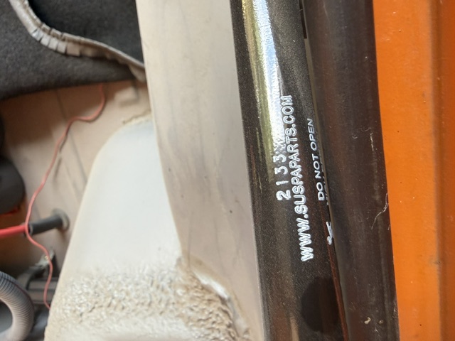

I was lucky and found a part number on my old struts. This is what I replaced mine with.
