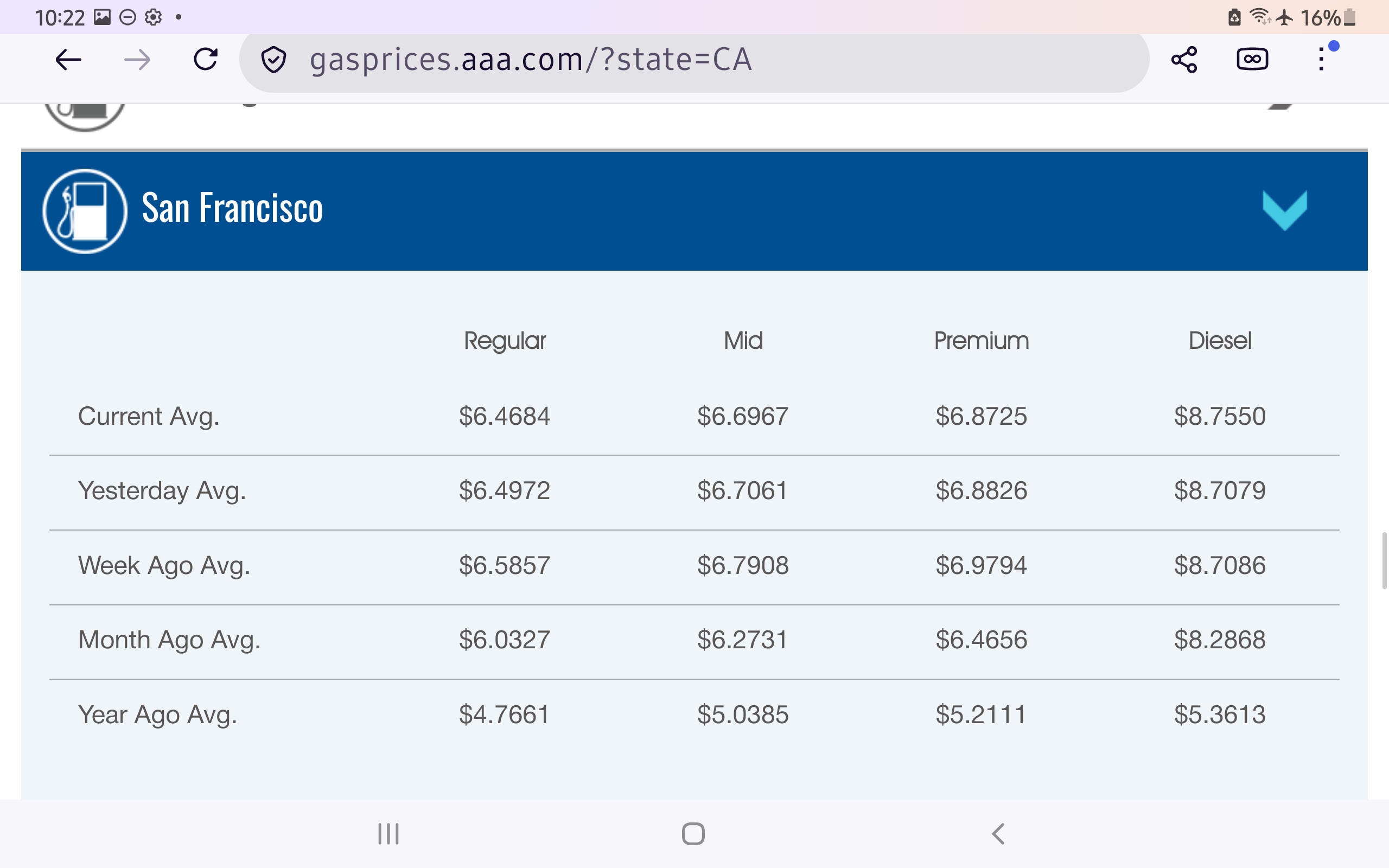

As you all know, gas (and diesel) prices are on a rampage and are the highest we personally have ever seen them. Maybe using E85 is a viable work around?
Take a look at the embedded table showing current gas prices and how they've skyrocketed the last year in the Bay Area (probably similar experiences elsewhere). Then last night we went to the store and E85 was selling at only $3.39.
