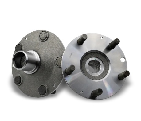

I'm considering this option for my 5 lug rear Fuchs (6x15) rather than the 944 cv joints. I have a narrow bodied car and these look easy to install along with new bearings. If you have tried these out, what's your experience been installing and driving? Is drilling the rear hub a better option?

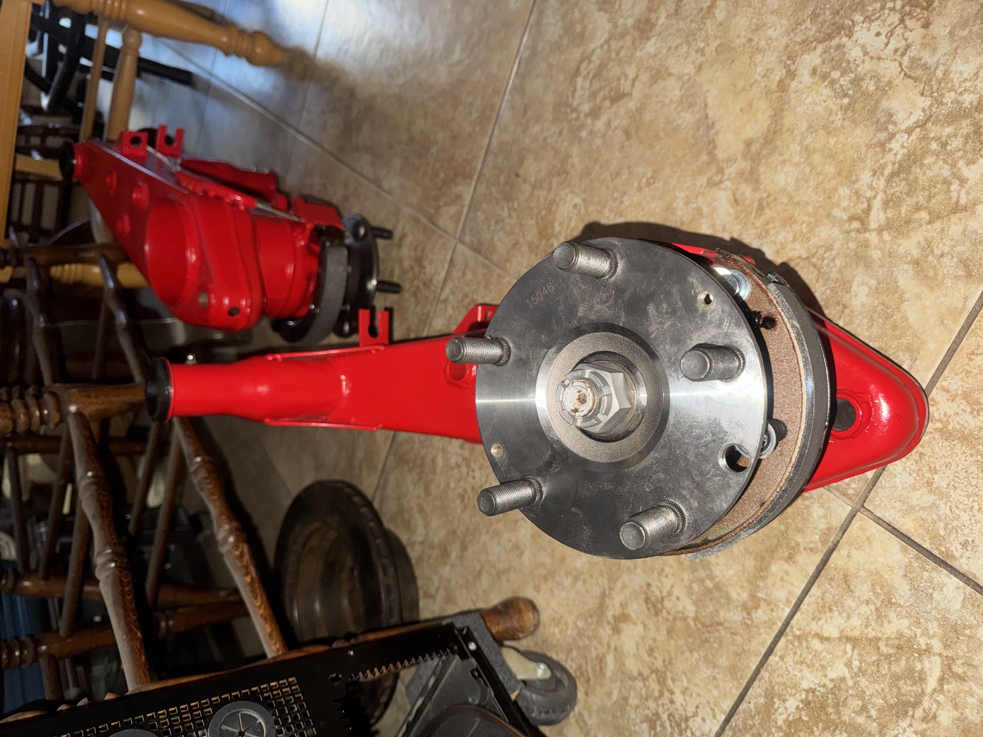

They worked fine. Lugs pressed in firmly and the hubs pressed into the bearings the same. Mine will be a wider version with at least 225's I am not worried.

They work but don't have the quality of the German made hubs.
I can sell you a nice pair of 914 redrilled hubs with studs at a better price than the Uro hubs..
The Uro work but they are softer Chinese metal the hub bulges when the studs are installed. So they reduced to OD so they would fit the rotor.
