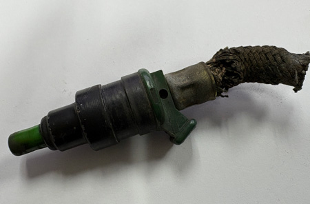

Hi,
"I am replacing the fuel hoses for all the fuel injectors. I think I need to cut off the metal crimp/end, but I am not sure what is underneath or what kind of clamp to use to prevent fuel leaks

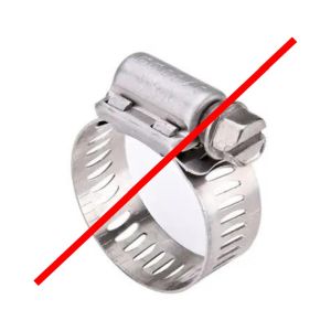

Use clamps with smooth walls, a smooth edge to not cut into the fuel line. NOT the worm gear style. You will need a couple differnt siuzes depending on the fuel hose OD used, verify what is needed before ordering.
