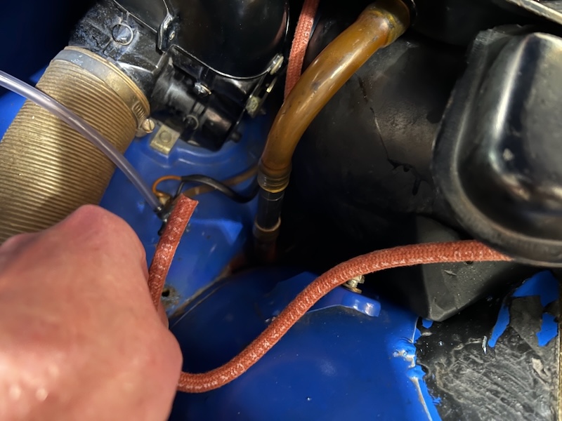

Where is the end of this hose coming off the expansion tank meant to connect? I can't find anywhere that it would reach. (IMG:style_emoticons/default/confused24.gif)
The parts catalog just lists its size and length: Hose 4 X 2,5 - 290 MM
Thank you.

The neck of the fuel tank has a nipple on the rear the hose attaches there.

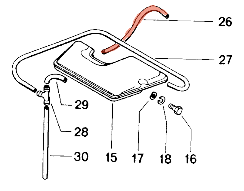

Here you go.

QUOTE(DennisV @ Oct 30 2026, 07:38 PM) *
Thank you.
Attached ImageAttached Image
second picture posted. a 6 that did not have a charcoal canister?
can see T connection in the drain tube that connects in the fume line from the expansion tank. the euro set up all ROW (except late japanese spec) had.
as others have posted short hose goes from the nipple on exp tank at front and connects to filler. how the expansion tank is connected to the fuel tank. in your set up the expansion tank is not in a closed circuit. its venting via the longer tube into the drain tube and fumes leave under the car - rather than go into the charcoal can circuit.
good for stinking up the garage. (IMG:style_emoticons/default/biggrin.gif) (IMG:style_emoticons/default/biggrin.gif) (IMG:style_emoticons/default/biggrin.gif)

i'm looking at dennisv's second photo in his original post fixer. he has two images in his first post.
if you look closely you can see his drain tube has a t in it and the line out of the right hand side of the expansion tank goes into this drain hose at the t. as per euro cars.
but just the same its interesting your car does not have a charcoal can either.

QUOTE(wonkipop @ Nov 2 2026, 12:58 PM) *
given the drain tube set up - do you know if this 6 was delivered 49 states when new and a 70MY?
Correct. No charcoal canister.

Sorry, misunderstood. Didn't get a picture but the expansion tank on mine has a small hose connection on each side. Driver's (right?) side loops underneath and goes to a 'T' on the large drain tube (gas tank overflow?). The passenger side goes to the tank fill housing.

yeah - thats the standard ROW set up fixer. (as well as those early 914s that went stateside in 70MY). (IMG:style_emoticons/default/beerchug.gif)
my old mate who owned the crayfords 73 2.0 had the same set up. no evap system in the ROW cars throughout all years. interestingly the japanese brought evap in for 73 i believe. and australia in 74. which is believe it or not what shut down private imporation of 914s via the UK and crayfords conversion to RHD. seems silly that no one thought back then to simply install the system on a UK delivered car bound for australia. would have been pretty simple to do - esp since the interior would have been gutted for the conversion to RHD. but they didn't. (IMG:style_emoticons/default/biggrin.gif) so the two 73 models that came here were the last ones in to go on the road at that time when the cars were new. (IMG:style_emoticons/default/beerchug.gif)
