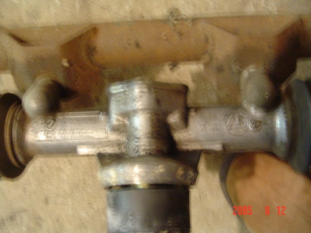

(IMG:http://www.914world.com/bbs2/html/emoticons/huh.gif) is there any differances between steering rack's fitted over the yrs and between the /4's & /6's ? Lock to lock ratio? serviceability?
I just pulled one out of a my 76 this WE and its quite different from the one's on my 73 and 74 cars (IMG:http://www.914world.com/bbs2/html/emoticons/cool_shades.gif)

parts book says they're alla same.
however - many 911's also use the exact same rack (same 914 part number and everything - Porsche liked the 914 dsign so much they used it in subsequent cars.
it's possible someone has retrofitted an early 911 rack into your car.
looks like the change occurred right around '71-'72 for 911.
does your mystery rack have a part or casting number ?

Yes I lll clean it an post but the most obvious differance is that on the most of the racks Ive seek there is a gear cover on the side of the rack, this one has two covers. One in the normal location and one at the bottem of the vertical section of the casting. (IMG:http://www.914world.com/bbs2/html/emoticons/confused24.gif)

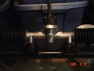

so here are a couple of bad garage shots
914werke
post Sep 12 2005, 09:24 PM
Posts: 11,295
Joined: 22-March 03
From: USofA
Member No.: 453
that was the common 914 rack,
Here is a blury shot of the rack in question

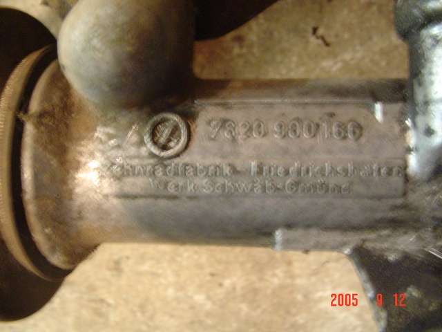

castings

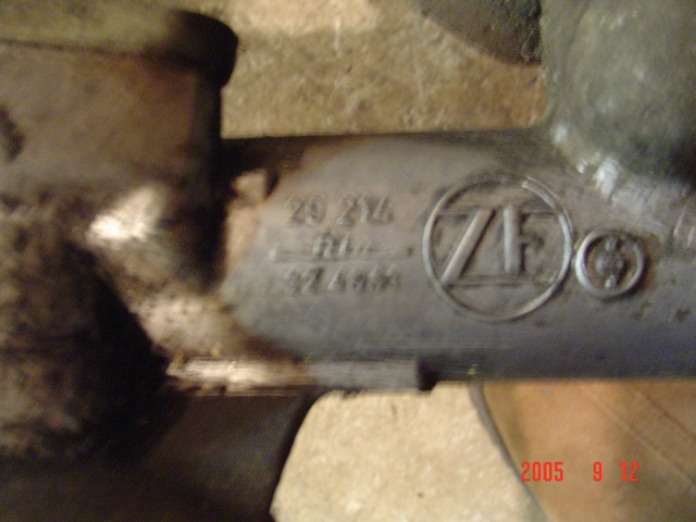

other side

You got a ZF! That's a limited-slip steering rack, very rare indeed.
Ok, I have no idea what it is, but you're right, it does look differn't.
