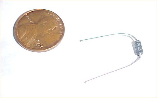

If it runs on after turning the key off....it prolly has an MSD ignition? Put a diode in the D+ circuit.

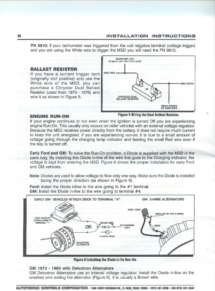

their is a MSD6A. No one way diode. Will the MSD pull power from the battery and send it through the system draining the battery?

Try this.....
Joe Bob
post Sep 17 2005, 03:01 PM
Posts: 17,427
Joined: 24-December 02
From: Boulder CO
Member No.: 5
and this....
