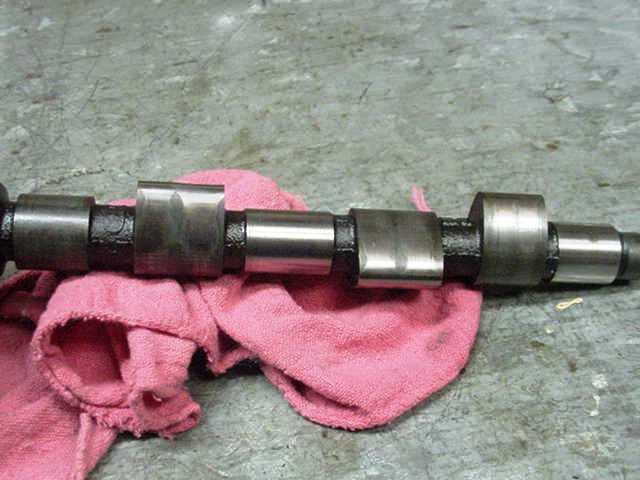

VERY noticable wear on one of the lobes. both visually and you can feel it when you run your finger over it. with the eccessive spring rates (duals) and whatever else was wrong, the lash caps and the adjusters were pounded pretty hard. so... new cam and lifters i guess. then there's the dilema of the "lifter issue" that i never saw or heard of being resolved. i don't know what the hell to do now.

a bunch of lobe pictures. overview. notice the wear marks on all of them.

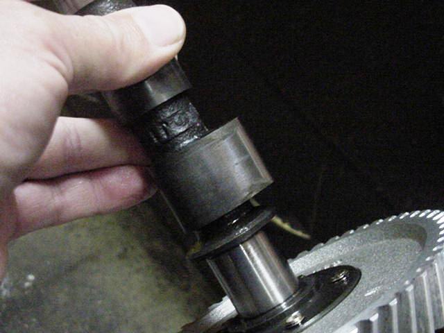

asdf

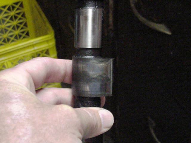

Member No.: 378

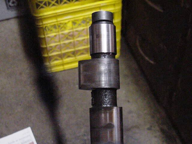

Member No.: 378

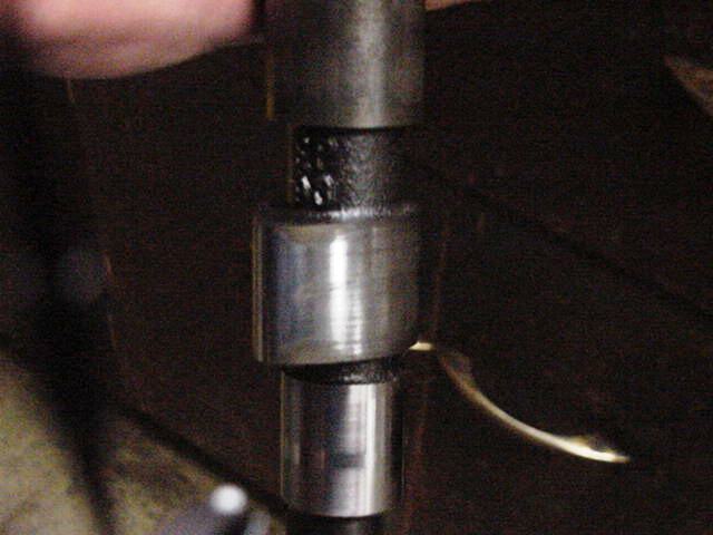

Member No.: 378

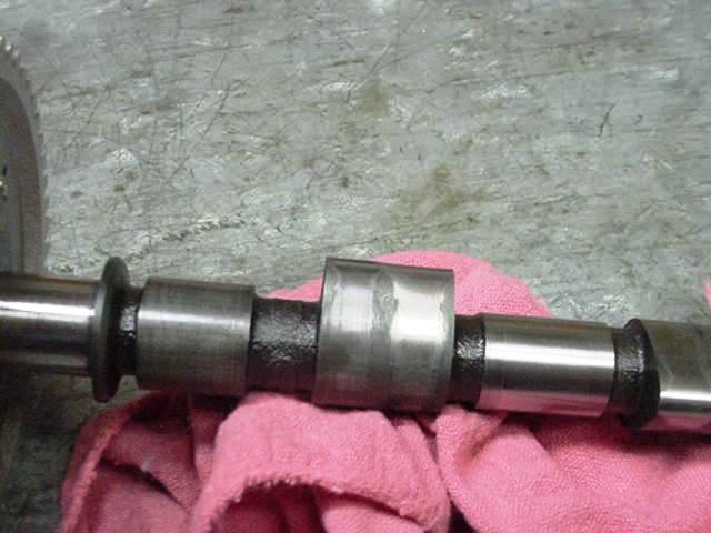

this is the worst of them all. you can make out the taper to the one side of the lobe. you can really feel the drop when you run your finger over it. why would it be so off center? lifter not sitting square to its bore?

As far as the failure.............
1.) Improper break-in of the cam
2.) Defective lifters (are they mushroomed)
3.) Improper matching of components (hard face cam lobes and soft lifters or visa versa...poor heat treating....
4.) Poor oil supply
5.) A 9000 RPM run up (several missed shifts or the motor was pounded & starved for oil)
6.) Excessive valve spring pressure
7.) Coil bind of the valve springs (improper installed height - Bent pushrods?)
8.) Defective grind on the cam
I can keep guessing.....................
