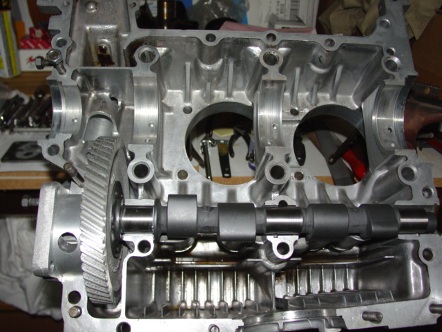

Dry mocking up my T1 pump to the case and Web #73 cam and gear I observed the following:
.055" apparent clearance between oil pump shaft and cam gear. Is this enough?
There is a void at the outer end of the gear post and gear of .68" that could be reduced via a press.
Watcha think?

The oil pump shaft goes into the cam itself. Its may have .055 worth of "slop" if you twist the gear back and forth... but not .055 front to back.

Yeah, I'll get a pic up. I'm doing a full case splitting rebuild and wanted a new pump, that's all. Seemed like the best and most affordable option. My concern is that the drive tang might be too long and bind up the cam. That's what I've heard anyways.

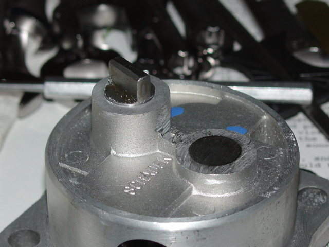

Modified pump
swood
post Aug 8 2003, 03:29 PM
Posts: 1,845
Joined: 6-February 03
From: Strong Beach
Member No.: 251
Here the pump gear with drive tang is not indexed to the cam gear, but butting up against it. The dimension seen is the amount of engagement the drive tang has with the cam, in this case 0.263".

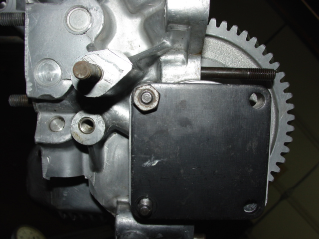

almost ready to go

pump cover. no interferance on the outside of pump...yet.
