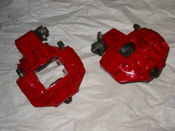

Finally, I have the calipers back together after waiting a while for new seals. Have a look.

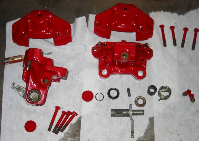

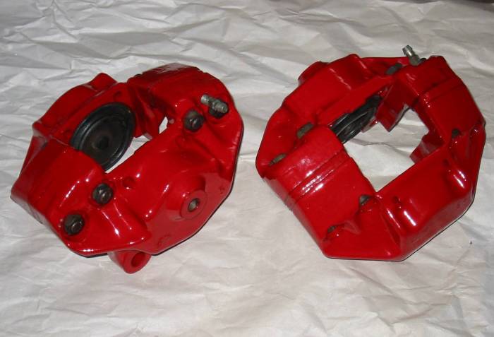

ChrisFoley
post Sep 8 2003, 04:01 PM
I am Tangerine Racing
Posts: 8,030
Joined: 29-January 03
From: Bolton, CT
Member No.: 209
and
Rusty
post Sep 8 2003, 09:14 PM
Posts: 7,993
Joined: 24-December 02
From: North Alabama
Member No.: 6
Did you mask off the e-brake arm, or disassemble that part of the caliper, too? (I can't see if the bottom metal disk was removed.)
-Rusty (IMG:style_emoticons/default/smoke.gif)

ChrisFoley
post Sep 9 2003, 05:18 AM
Posts: 8,030
From: Bolton, CT
Member No.: 209
QUOTE(Lawrence @ Sep 8 2003, 11:14 PM)
here's a pic of the rears during reassembly.
ChrisFoley
post Sep 9 2003, 05:21 AM
Posts: 8,030
From: Bolton, CT
Member No.: 209
QUOTE(SirAndy @ Sep 8 2003, 11:25 PM)
for a $1000 bucks you could have cleaned those nuts and bolts before you put them back on (IMG:style_emoticons/default/laugh.gif)
a wire-wheel sometimes does wonders ...
Andy
Hey Brad2,
they weren't too bad, imo. The black anodize was still largely intact and I didn't want to remove it. I only wirebrushed the threaded mating portions, lol.
Rusty
