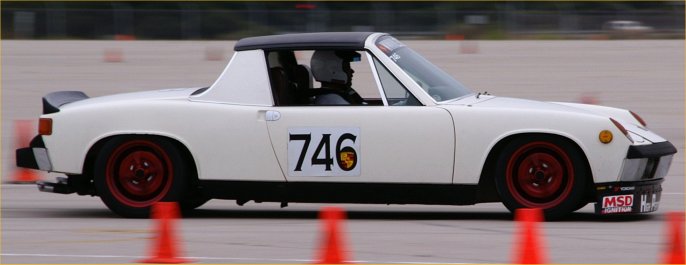

ive seen a few pictures of 914's with this small rear spioler wing thing on the rear trunk lid
do those even create any down force?
is that down force that it would create necessary?
are they coustom made?
where would i go about getting one if they arent?
those things look pretty cool

The duck tail? (IMG:http://www.914world.com/bbs2/html/emoticons/biggrin.gif)
It doesn't do much of anything until you are going somewhat over 100 mph.

Spoilers: disrupt the airflow over the rear decklid decreasing the chance of lift at the rear of the car.
Wings: create downforce depending on their angle of attack from the leading edge to the trailing edge.

Actually, most add them for looks. They do imporve air flow, but probably at higher speeds that you would drive on the street. An engineering student in San Diego was doing a study on the effects of spoilers for a class last year. Never hear/saw any results.
I have a NOS spare if you want to purchase one locally, or you can buy them from a number of vendors on line.

IMHO the ducktail is there to cause a bigger vacuum behind the car. This helps suck air out from underneith the car, which in turn helps suck the car to the ground. From the people I've talked to, it's quite effective, but probably only worth doing if your into some kind of competition, or perhaps if you're just into pushing it all the time. (IMG:http://www.914world.com/bbs2/html/emoticons/smile.gif)

If you like the way it looks, put one on (IMG:http://www.914world.com/bbs2/html/emoticons/biggrin.gif) , on a 914 for airflow, down force, or something else, you are wasting your time and money, racing or not. If you want to check it, tape short pieces of yarn to the back lid and slightly over the back of the car, and take a video. Then figure out if the down force is worth the drag. I Don't believe it is, but I think they look nice.
