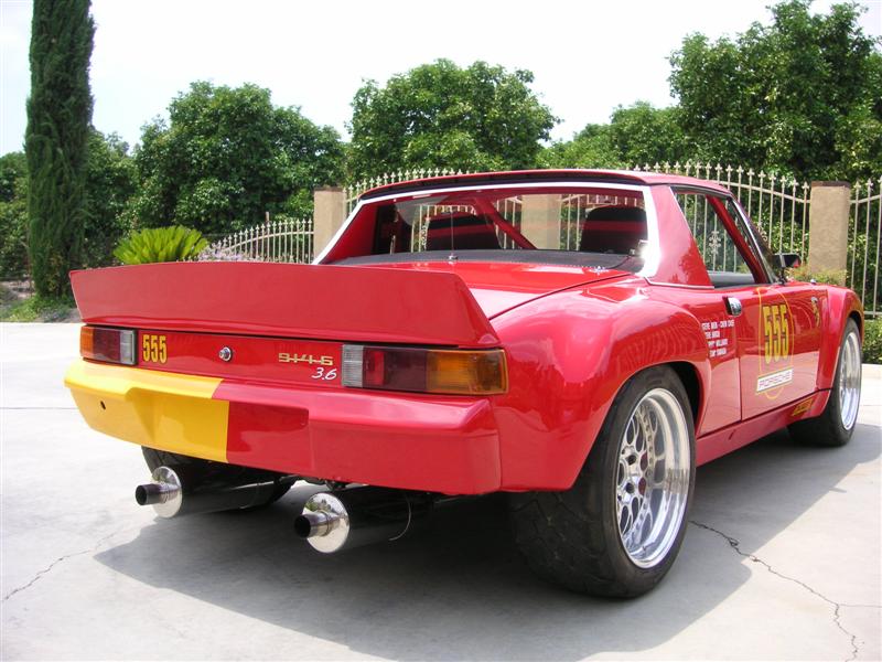

(IMG:http://www.914world.com/bbs2/html/emoticons/ohmy.gif) A rear spoiler makes a huge difference in a high speed turn like turn 8 (100+mph) at Willow Springs International Raceway.

Yes, Dan is right, and he has the one that really works...Sheridan's SCCA legal rear spoiler. It looks good in red! My mechanic in LA has the original Sheridan prototype on his 914 racer.

(IMG:http://www.914world.com/bbs2/html/emoticons/agree.gif) the ducktail spoiler is not about downforce. the turbulence it creates helps sucking air out from under the rear of the car, thus counteracting some of the "lift" you get at higher speeds ...
another thing you can do to help eliminating lift is running without the rear valance.
the effects can be felt at speeds well under 100mph ...
(IMG:http://www.914world.com/bbs2/html/emoticons/cool.gif) Andy
ducktail and cut open 916 rear bumper to help getting the air out from under the car ...
