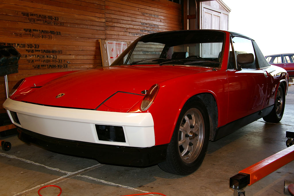

My thoughts (for the winter) of ducting air through the fog light holes to the radiator didn't work. First trial run with the bumper installed had the engine temp approaching 210 degrees within 2 miles of driving in 70 degree weather. That led to a hasty cut (IMG:http://www.914world.com/bbs2/html/emoticons/sawzall-smiley.gif) in the glass bumper, which cured that problem.
