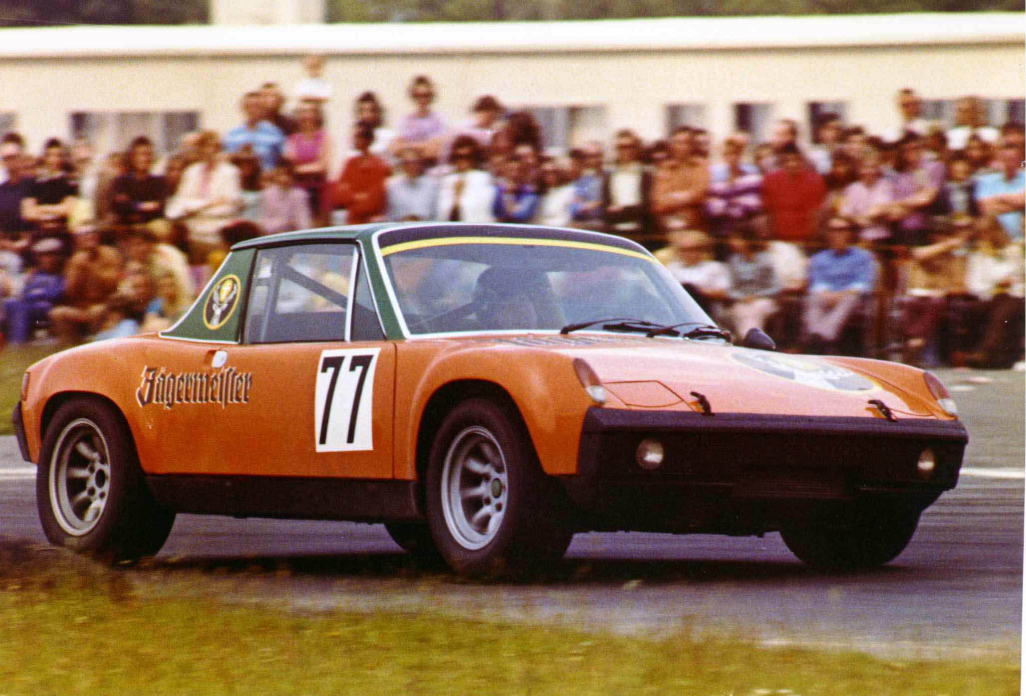

Wasn't there a 914 GT with dark green vinyl all around....Jager car?

QUOTE (trekkor @ Oct 26 2005, 07:07 PM)
nope, that was paint. "condagrün" to be precise ...
(IMG:http://www.914world.com/bbs2/html/emoticons/cool.gif) Andy

Trekkor

QUOTE (trekkor @ Oct 26 2005, 09:04 PM)
can I see the picture anyway? (IMG:http://www.914world.com/bbs2/html/emoticons/smile.gif)
demanding, aren't we? (IMG:http://www.914world.com/bbs2/html/emoticons/smile.gif)
914.143.0178, at a race in Germany in 1972, car was originally build by
"Max-Moritz" in 1971 and was painted all "condagrün".
Ekkehard Schimpf (then owner and driver in the picture) bought it in
1972 and painted it "signal-orange" and added the Jägermeister decals,
but left the top and sail panels and a-pillars "condagrün" ...
