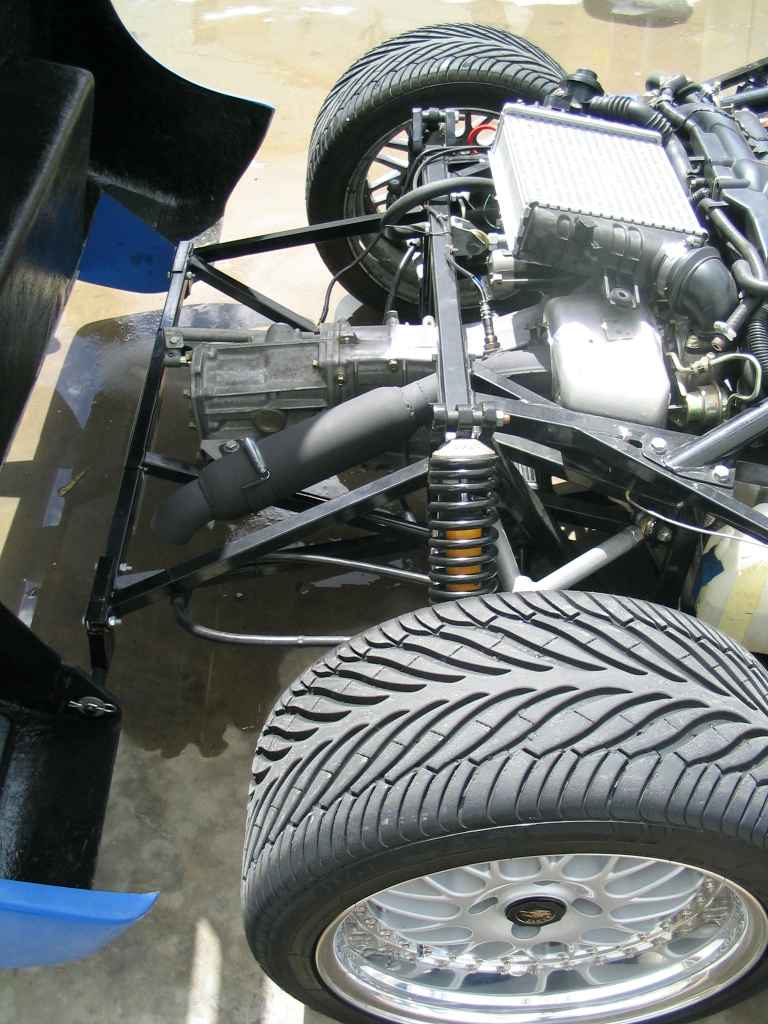

(IMG:http://www.914world.com/bbs2/uploads_offsite/www.sakercars.com.au-3518-1269662543.1.JPG)
That's a Suby AWD trans converted to RWD with 2 parts <!-- emo&:beer2: -->(IMG:http://www.914world.com/bbs2/html/emoticons/beerchug.gif)<!-- endemo -->
Convertor sleeve: AUD$120.00
Blanking plate: AUD$110.00
If bought together, total price AUD$210.00
Looks like a side shift linkage could be tweaked to work.
I just bought a 2005 (EJ25) engine and trans (2000 miles) for the 914 - let the fun begin.
I just sent an e-mail to sakercars to check on parts availability.
Steve. <!-- emo&:beer3: -->(IMG:http://www.914world.com/bbs2/html/emoticons/beer3.gif)<!-- endemo -->

Here is everything I know so far,
There was a little confusion with RWD and FWD - they use the term FWD to describe the AWD transmission with the original stuff to drive the rear end removed.
Suby 2 wheel drive conversion parts
G'day Guy,
Yes, we do have the parts to convert the Subaru box to 2wd. The parts for the
conversion consist of a machined locking sleeve and a cast aluminium backing
plate for the extension housing. Please note that these items will only suit a
5 speed Subaru box, not the 6 speed.
Prices for the parts are as follows:
All prices are in Australian dollars and shipping will be additional to these
prices.
Please let me know if you would like to go ahead with your order, and don't
hesitate to contact us if you have any further questions.
Best Regards,
Brett Longhurst,
Saker Cars Australia
Hi Steve,
The parts we have actually convert the AWD box to front wheel drive for use as a transaxle in a rear mount engine configuration. The extension housing is removed from the rear of the gearbox and a blanking plate fitted to centre diff housing. All the torque is sent to the front diff inside the gearbox.
Converting the box to RWD is a different matter, which we haven't done before.
If you get stuck, we could possibly look into what would be required to do a RWD conversion for you, but I can't make any promises. What application are you using the gearbox in?
Best Regards,
Brett Longhurst,
