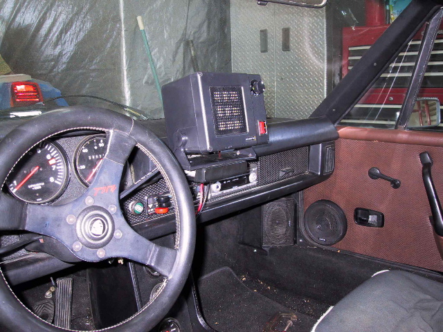

Depends on how much heat you are looking for.
I used this in my car last fall at temps below freezing and was surprised on how well it worked.
I dont drive my car during the winter here in Minnesota but the electric one worked fine at temps below freezing. It throws enough heat to keep the cabin warm and kept the windshield clear.

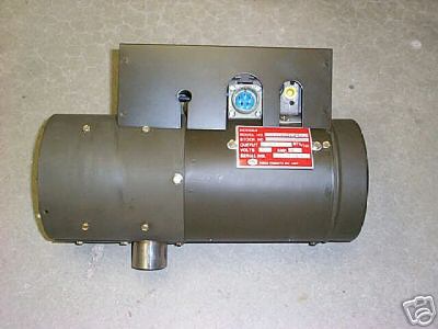

Somebody install one of these so I copy from you!
http://cgi.ebay.com/ebaymotors/UNIMOG-PINZ...sspagenameZWDVW

Yes that's what I was talking about. I don't plan to be driving my 914 in really cold weather. Here in Washington when it is cold it is usually also raining. Not good for a 914. Where did you get this and is it powered by the cig liter?

QUOTE (East coaster @ Nov 7 2005, 08:36 PM)
I just bought one (IMG:http://www.914world.com/bbs2/html/emoticons/smile.gif) (IMG:http://www.914world.com/bbs2/html/emoticons/smash.gif) (IMG:http://www.914world.com/bbs2/html/emoticons/welder.gif) (IMG:http://www.914world.com/bbs2/html/emoticons/screwy.gif)
Hope it doesn't melt my carbonfiber hood (IMG:http://www.914world.com/bbs2/html/emoticons/wacko.gif)

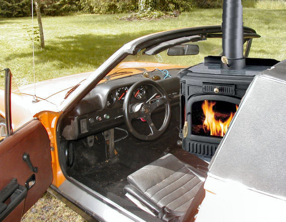

this is how we heat our cars in Oregon:
