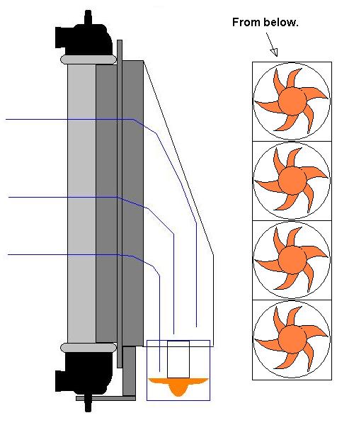

So I've been thinking about different ways to get air up to the radiator in the subaru conversion where the radiator is in the engine bay. The standard way to do it is to have a couple of normal radiator fans sucking air from beneath the car.
Here's another idea... What if I constructed an array of ducted fans as in the diagram below. Basically they would force air up the shroud and through the radiator. One advantage to this is that it would take advantage of the entire surface of the radiator, rather than a round section that a fan would push through.
Something I'm trying to figure out is the conversion between thrust and CFM of air moved. Most of these fans are for hobby RC airplanes and are rated in ounces of thrust, rather than moved volume of air.

TonyAKAVW   Another silly idea   Nov 10 2005, 05:36 PM
Andyrew   What do they equal in CFM? I would want some forc...   Nov 10 2005, 05:42 PM
bondo   <...   Nov 10 2005, 05:42 PM
WRX914   Looks like it should work... Would the fans be on...   Nov 10 2005, 05:46 PM
lapuwali   I've ruminated on a chimney-effect idea, which...   Nov 10 2005, 05:47 PM
Mueller   do you still plan on installing "puller" fans to t...   Nov 10 2005, 05:47 PM
SLITS   Add a couple more and you could have a 2J Sucker C...   Nov 10 2005, 05:48 PM
TonyAKAVW   I had actually thought of having the exhaust of th...   Nov 10 2005, 06:01 PM
Aaron Cox     Nov 10 2005, 06:04 PM
Andyrew   what if you shrouded scoops to the sides of the ca...   Nov 10 2005, 06:15 PM
jim_hoyland   Tony, I've got a couple of in-line Detmar bra...   Nov 10 2005, 06:17 PM
Rand   The stock air-cooled setup pulls the cool air from...   Nov 10 2005, 06:18 PM
jd74914   it seems like it should be a low pressure area beh...   Nov 10 2005, 06:21 PM
Aaron Cox     Nov 10 2005, 06:22 PM
Rand   The expanded metal grill in the engine lid is the ...   Nov 10 2005, 06:24 PM
Aaron Cox     Nov 10 2005, 06:25 PM
Andyrew   the expanded metal grill in a stock 914 has a rain...   Nov 10 2005, 06:28 PM
TonyAKAVW   It is the intake, but its probably not the best ar...   Nov 10 2005, 06:29 PM
Aaron Cox     Nov 10 2005, 06:38 PM
jsteele22   Hi Tony, I think with air-handling equipmen...   Nov 10 2005, 06:43 PM
brer   there are custom hot rods that get their cooling f...   Nov 10 2005, 06:48 PM
