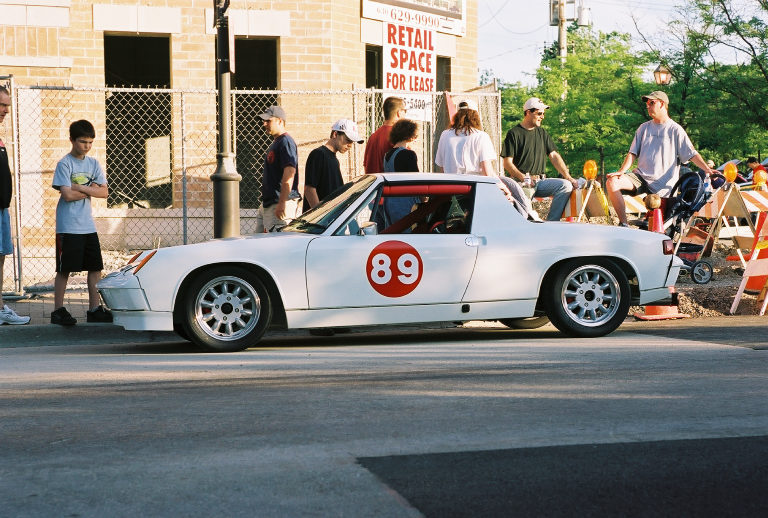

If the car has real minilites buy it right now (IMG:http://www.914world.com/bbs2/html/emoticons/smile.gif)
On a second note, I'm 17 and have been putting together a teener which didn't run when I got it. It had quite a bit of rust and I have made replacement panels for all of the patches. If you have a welder and can learn how to weld go for it (as said in the last post). As long as you have the time and determination, 914s really are not that cost prohibitive to restore. I'll have mine on the road with very little invested into it as I have hunted for deals and done everything myself.
BTW: the car below has minilites

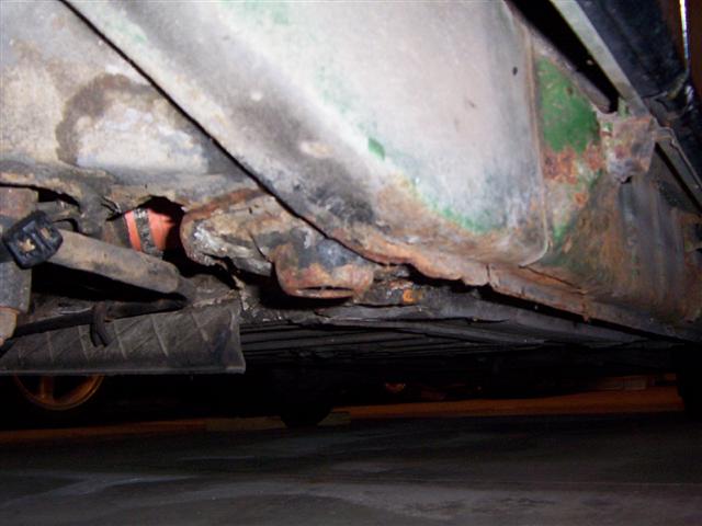

someone else's pic but it is rusted through around that round nublet thing near the center of the pic...this is prob. the jack point......is this repairable?
Yes, there are parts availible to fix that area. You have to really poke around the jack points and uncover all the rust. there is always more then you think.
