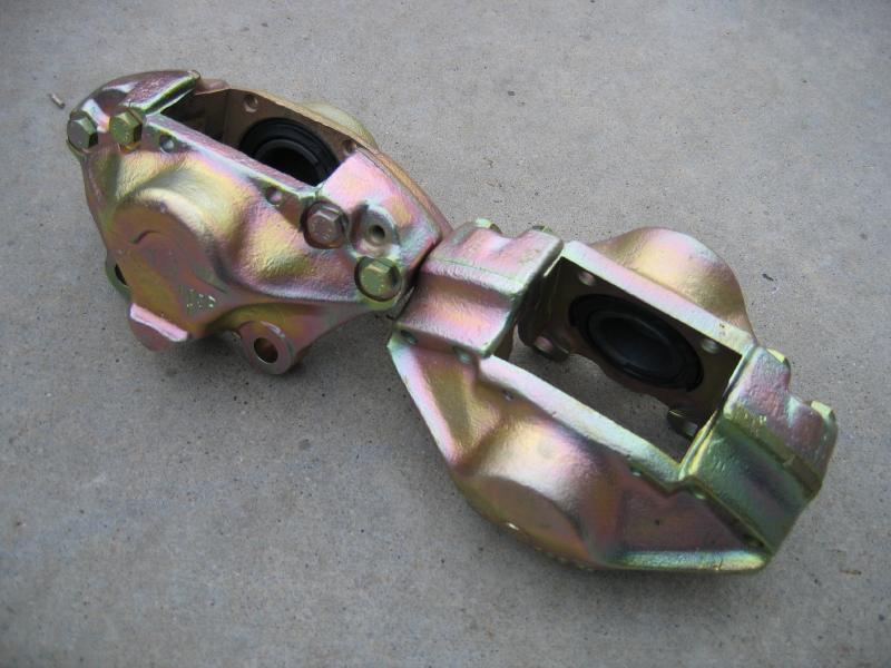

These would bolt right on (extremely shameless plug for my classified ad) (IMG:http://www.914world.com/bbs2/html/emoticons/biggrin.gif)
