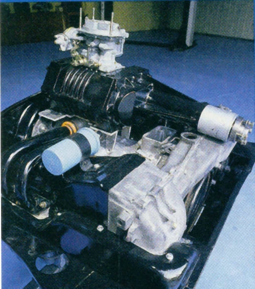

1st thing to do is "remove" carburator from your vocabulary (IMG:http://www.914world.com/bbs2/html/emoticons/smile.gif) I know pictures have been posted before, yet no luck in finding them....I guess best bet is to close your eyes and picture this supercharger sitting on top of the motor...the belt would be driven off a pulley that is in between the fan and the motor....there was a company in FL many, many years ago that installed a supercharger and might have made a kit, but I have never seen anything about it except some really poor pictures printed in VW & Porsche magazine 20 years ago. Best bet it spend $23 for SUPERCHARGED, by Corky Bell available at amazon.com Attached image(s) ![]() |

This was covered not too long ago (April 05). Search 'supercharger'. I posted part of the VW & Porsche magazine article and pics of the supercharger install. It looks like the supercharger w/ carb would be easier to do than a turbo, since you could use a single Holley carb and manifold set up and slide a supercharger in between the carb and manifold. The motor in the article was substantially beefed up to handle the extra stress of boost. Putting it together is one thing, KEEPING it together is another...

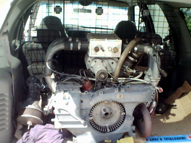

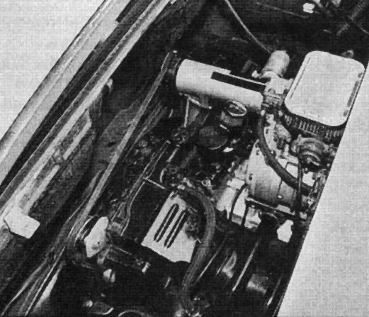

This is the only photo of a supercharged T4 I have (I think this is actaully a T3?):

supercharger on a T4

Last one. If anyone knows where these came from please enlighten me. (IMG:http://www.914world.com/bbs2/html/emoticons/wink.gif)
I wish I had more, esp. since I don't know anything specific about the pictured engines Attached image(s) ![]() |

the second picture is from the magazine article, company name was something like RPM Motorsports in Florida (no longer around, someone tried looking them up) |

I like the one with the progressive carb! Hell that carb won't even flow 175 CFM- Its not even enough for a stock 2 liter N/A engine!
