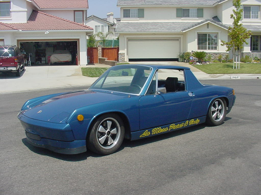

I have always loved the 914/6 GT's and will be converting this orig 6 (below) to an updated GT plus try to build a TTOD capable AX’r. (IMG:http://www.914world.com/bbs2/html/emoticons/smile.gif)
It will be pretty much be a straight up racer, no heat, no radio, no nuthin, almost a full GT car but with no roll cage. To get to TTOD I felt that I needed a few things I did not already have, such as more rubber beneath me, more low end torque, closer gear ratios, LS diff, more tuneable suspension, body stiffening, yadda yadda, you get the drift.
This first pic is when I bought her in August 02, she's a factory six with a 3.2 and 915 trans, 911s suspension, was PCASDR 99 & 2000 AX champ for class HI.

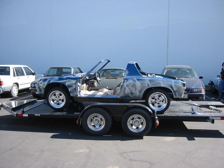

March 2005, Car is stripped except for wheels & steering wheel. Going to the sandblast booth here. We found that this car had 7 paint layers, mucho bondo, and a couple of really hack body repairs. We estmate that we removed over 100 lbs in paint, the paint was 3/16" thick! (Go back to the first post for a clue as to who did this custom (HACK) paint work.

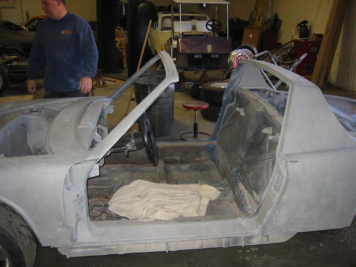

March 2005, Here 99% of paint has been sandblasted off. Metal work to start. Guy in pic is Brian from Temecula Rod & Custom, he is a master metal worker, claim to fame is he appeared on early Monster Garage episodes. (IMG:http://www.914world.com/bbs2/html/emoticons/biggrin.gif)

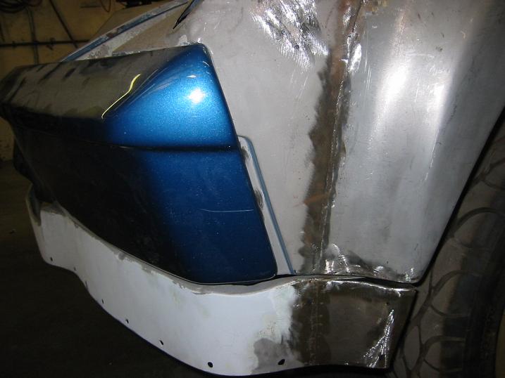

May 2005 Some of the metal work completed. Note how the steel front spoiler is custom flared at the end to match the GT flares. (IMG:http://www.914world.com/bbs2/html/emoticons/biggrin.gif)

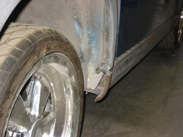

Pic: Rocker panels custom flared to match GT flare, extra structural bracing added to fight cone damage at AX's.

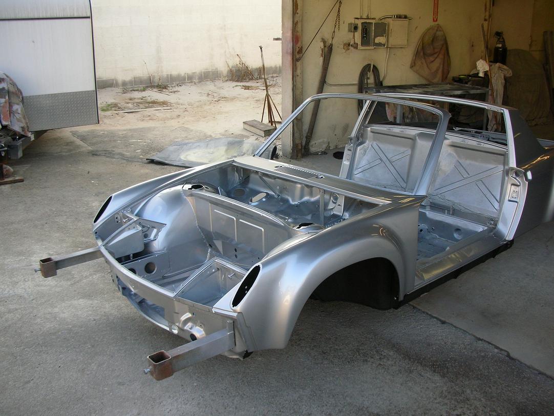

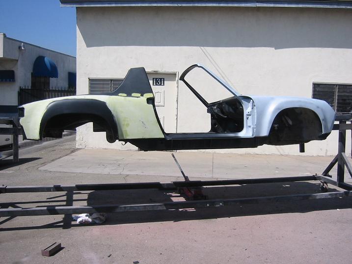

July 2005 Finished metal work, tub on rotissere with some body filler & being prepped for paint. (IMG:http://www.914world.com/bbs2/html/emoticons/biggrin.gif)

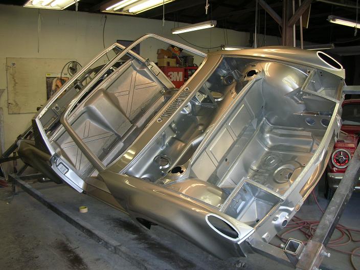

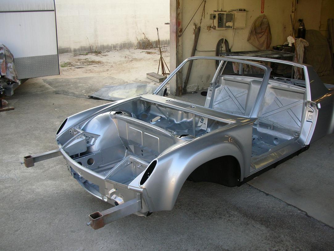

11/22/2005 Paint on tub finished, Carrera GT Silver. Tub to go on lift this Friday, assembly starting yay! (IMG:http://www.914world.com/bbs2/html/emoticons/drooley.gif)

Andrew (the paint meister) is an artist, for hard to get areas I think he used a wand tip, kinda like a garden sprayer, plus he could turn the tub upside down purty easily.
Next pic: full shot of painted tub, on rotissere.

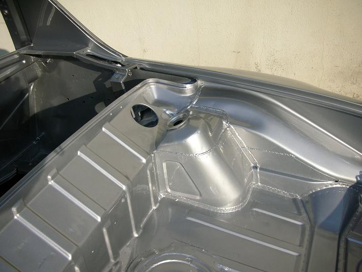

Pic: shot of rear suspension seam welding.

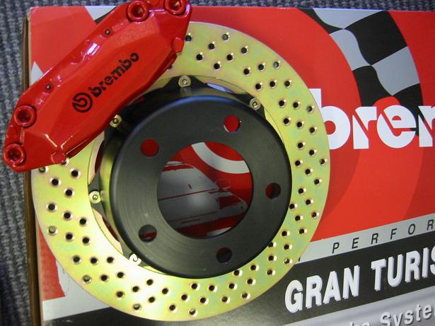

Brake porn: Brembo GTP lightweights, 12.3" full floating rotors.
