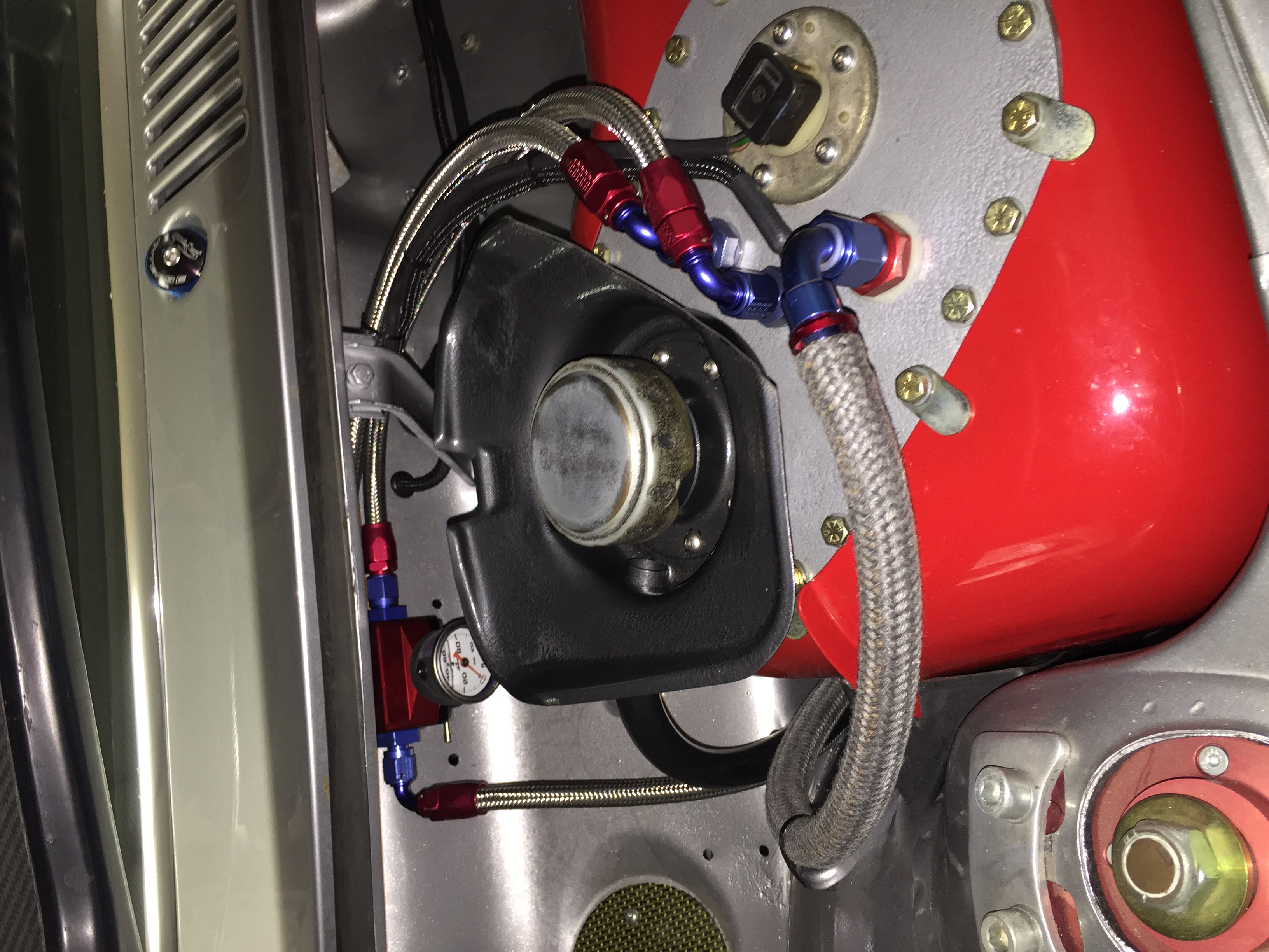

Marv's3.6six   1/11/06 Oil lines finished in front trunk, top vie...   Jan 12 2006, 08:09 AM
Marv's3.6six   01/11/06 Oil lines lower view, to Tstat.   Jan 12 2006, 08:10 AM

Aaron Cox   marv, any worries about the hot oil lines runnin...   Jan 12 2006, 12:00 PM
Marv's3.6six
  Jan 12 2006, 02:44 PM

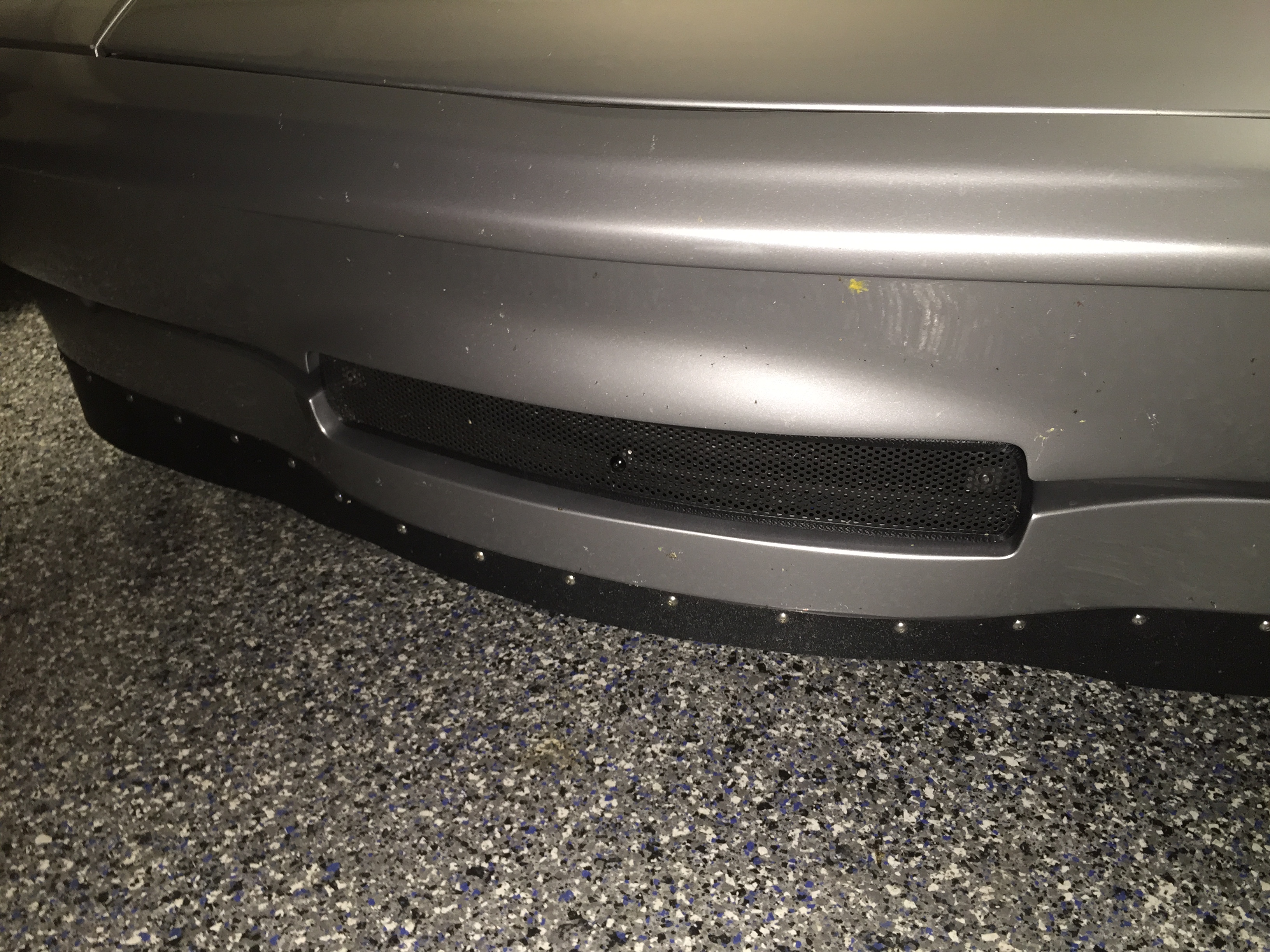

Marv's3.6six   1/29/06 Fabricating lower valence, ABS spoiler.   Jan 29 2006, 08:16 PM
Marv's3.6six   1/29/06 Lower valence with spoiler, front view.   Jan 29 2006, 08:18 PM
Marv's3.6six   1/29/06 Side view. http://www.914wo...   Jan 29 2006, 08:20 PM

Jeroen   nice! Is that a regular GT front valence? Or s...   Jan 29 2006, 11:08 PM
Marv's3.6six
  Jan 30 2006, 12:07 AM
