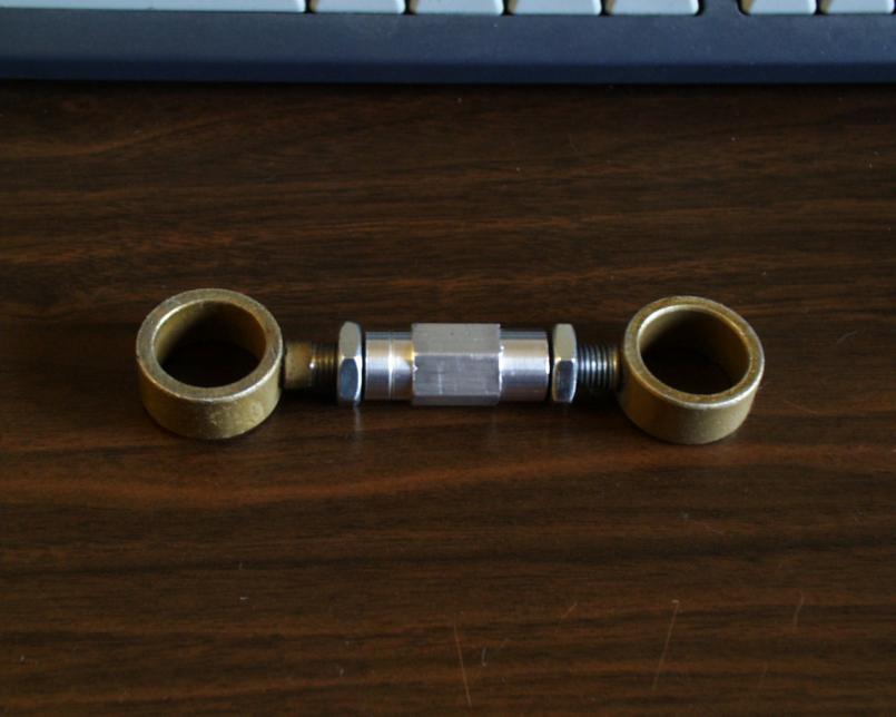

QUOTE(Aaron Cox @ Nov 26 2005, 04:40 PM) *
<!-- QuoteBegin nebreitling+Nov 26 2005, 05:38 PM --></span><table border='0' align='center' width='95%' cellpadding='3' cellspacing='1'><tr><td>QUOTE (nebreitling @ Nov 26 2005, 05:38 PM)</td></tr><tr><td id='QUOTE'><!-- QuoteEBegin --> i've actually been thinking about fabricating these on my own, so i'd be in for a quality set, brando.
after corner-weighting the car, i have some serious preload on the rear bar. (also thought about just cutting and welding it to shorten one side...) <!-- QuoteEnd --> </td></tr></table><span class='postcolor'> <!-- QuoteEEnd -->
cut in the middle, get a die and cut left and right hand threads on it, and make a female threaded middle piece....
basically mod the old dogbone into an adjustable length droplink
Like This -
I was looking for the same thing and modified one of my stock drop links. I used M10X1.25 taps and dies and made the turnbuckle on a lathe.
(IMG:style_emoticons/default/smash.gif)
Paul

QUOTE(Phoenix-MN @ Jul 25 2008, 02:37 PM) *
Like This -
i see a group buy in the near future ...
(IMG:style_emoticons/default/thumb3d.gif) Andy

I guess I didn't know I was going into production on these (IMG:style_emoticons/default/confused24.gif) If I were to do this, I would require people to send me their drop links to modify since the links are not easily sourced. I also would have to figure out what to charge (IMG:style_emoticons/default/idea.gif)

I love old threads with progress (IMG:style_emoticons/default/smile.gif)
sick design!
