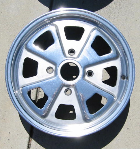

There should be a 914XXXXXX part number on the back side along with a vw insignia.
Also there should be a lip on the outer rim edge that is similar to a steel wheel. If it is smooth with no lip...definitely a fake.
Should look like this:

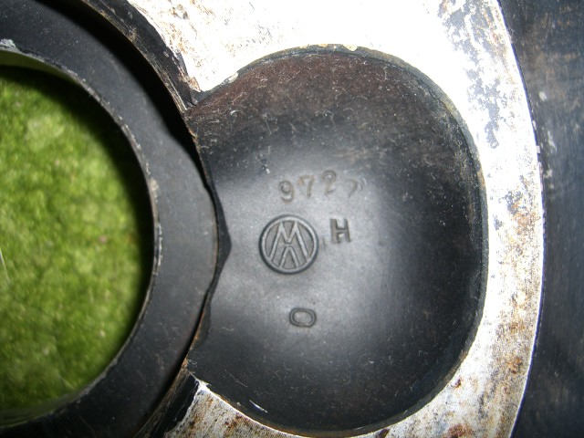

here are some pics of the back side of real 2.0L Fuchs.

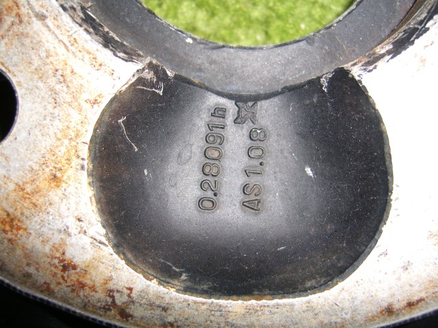

nuther

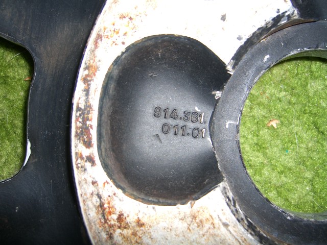

nuther

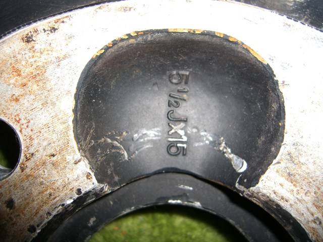

last one

dang, nice pictures Dan, what kind of camera??
