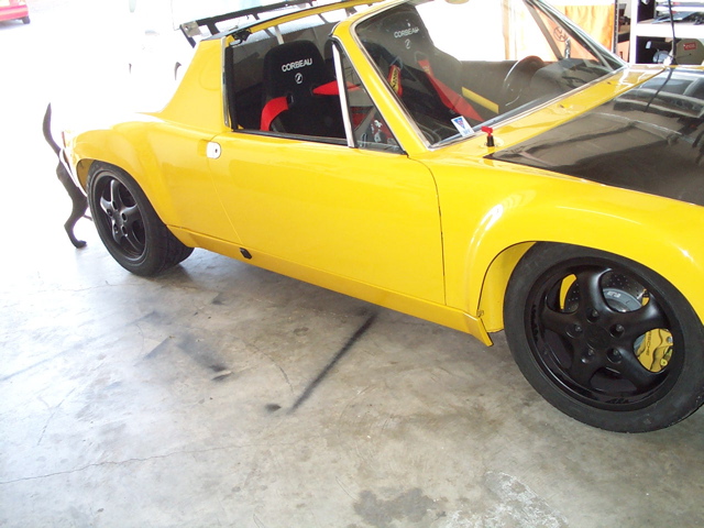

Anyone running 993 or 996 wheels on a flared 914
looking at 17 x 7 offset 7-55 and 17 x 9 offset 9-55.
Not sure what size spacers I would need to maker these work .
looking for someone that has done this ?

17x7 front 17x9 in the back 993's 1.5" spacers all around but probably could go with 2" in back. Front fenders are pulled a little and I had to trim the front lip so I could steer.
Edit: The tires are 225/40 front and the back are 255/35 Bridgestone SO-3. Just the perfect tires for these wheels. I don't think all 255's will work but my tires have the bead pretty far in towards the center of the tire.
(IMG:http://www.pelicanparts.com/MotorCity/smrz9148/silverSideView.jpg)
(IMG:http://www.pelicanparts.com/MotorCity/smrz9148/silverRearFlare.jpg)
I no longer have stock rear breaks. so this last pic is outdated.
(IMG:http://www.pelicanparts.com/MotorCity/smrz9148/silverRearRotorBehindWheel.jpg)
